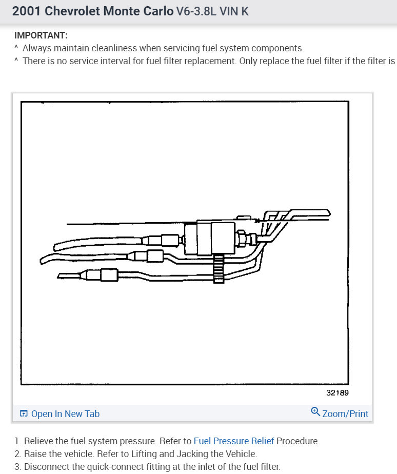

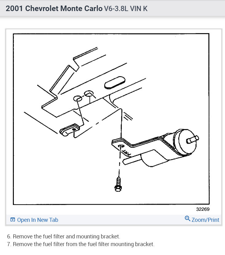

where will i find the fuel filter?
Apr 18, 2009 at 8:23 AM
JDL
  • 16,098 POSTS
Hello, my info shows, it is located by the gas tank, you may have to get under the vehicle. Here is a guide to help you walk you through the steps and diagrams below to show you on your car.
https://www.2carpros.com/articles/how-to-change-a-fuel-filter
