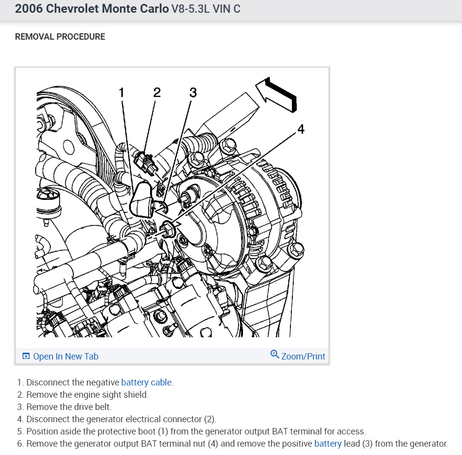

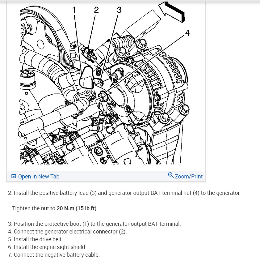

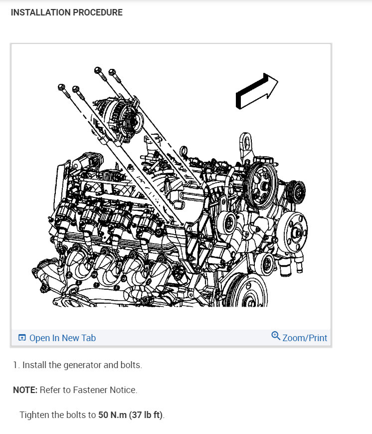

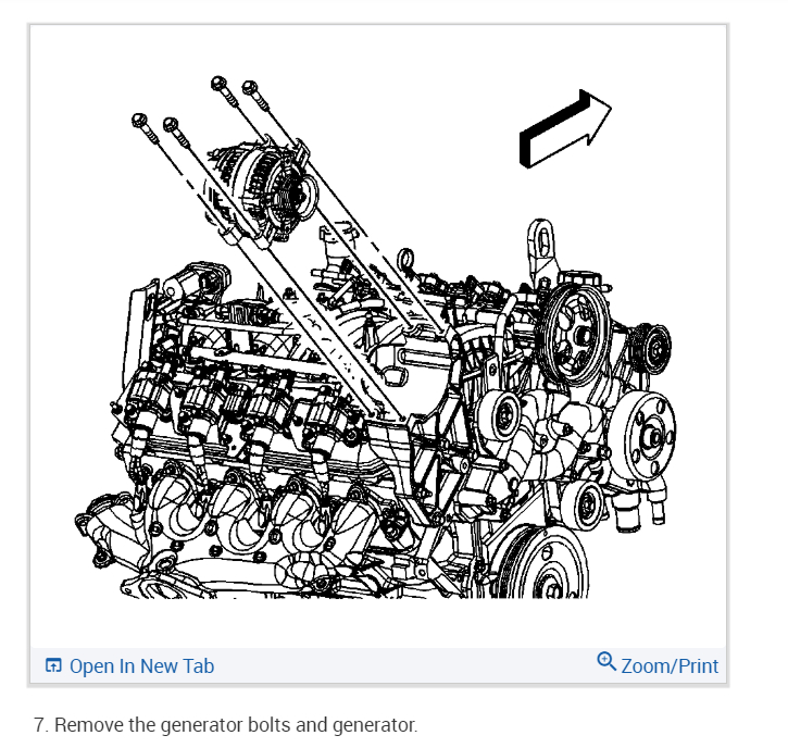

how to replace alternator?
Feb 25, 2009 at 8:08 PM
BLUELIGHTNIN6
  • 16,542 POSTS
This guide will help walk you through the steps with instructions in the diagrams below to show you how on your car.
https://www.2carpros.com/articles/how-to-replace-an-alternator
