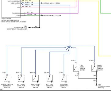

The sound that goes off when the car door is open will not shut off. It is draining the battery. How can I disable it.

You can't disable it as I see it. Teh electrinic brake control module is on that circuit, so you can't pull the fuse, and if you pull the chime module, you lose the trun signals. There is a problem with a ground or door jamb swtich I believe.
https://images.2carpros.com/forum/automotive_pictures/30961_chime_1.jpg

Suggested Repair
Do not disable the chime by pulling the fuse or chime module; the electronic brake control module shares that circuit, and removing the chime module disables the turn signals. Inspect the door jamb switch and related ground.
