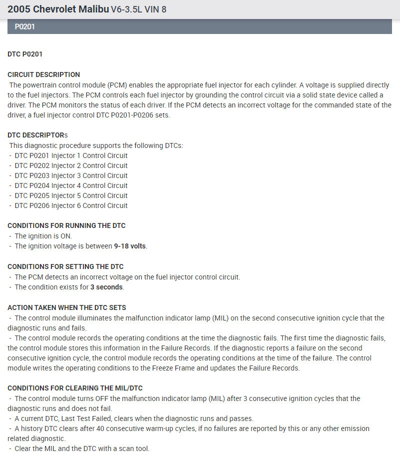

This could be due to voltage supply issue to the given injector circuit.
Please note that your vehicle has 6 injectors and their respective circuits. In order to know which injector we will need to know the exact code
As the injector circuit can refer to any of the six (or multiple injector circuits) injector circuits.
You can always get the vehicle scanned at your local auto parts store. They will scan and can provide you with the code.

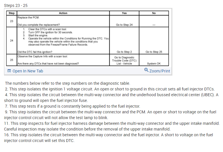

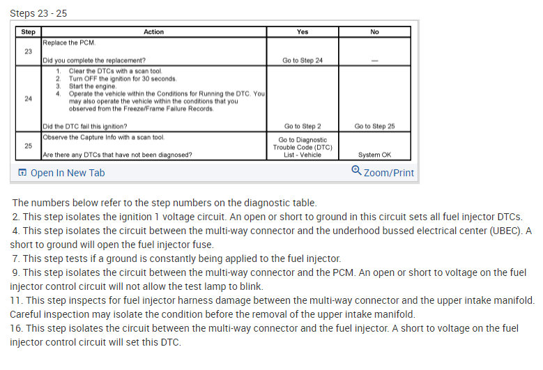

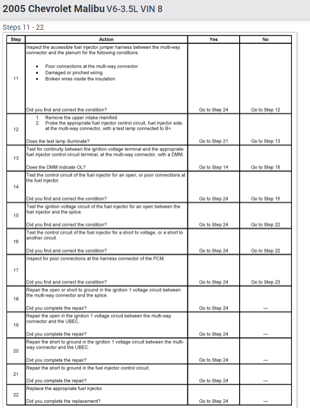

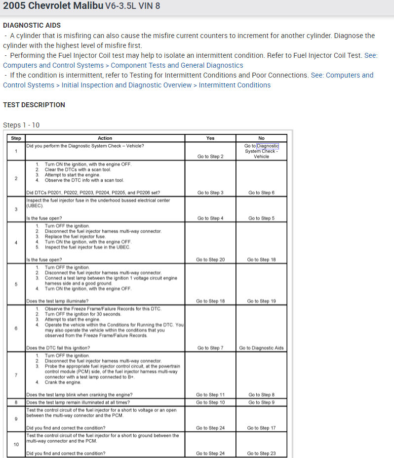

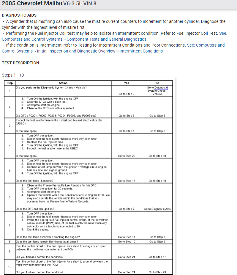

I have attached the diagnostics for the injector circuit code. Note: you will just need to know which injector circuit that is triggering the issue, as the diagnostics is the same.
