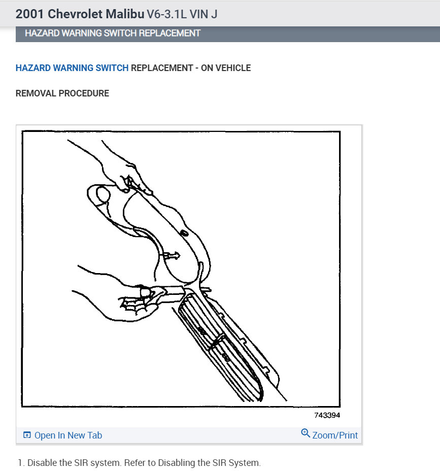

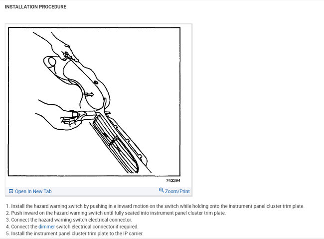

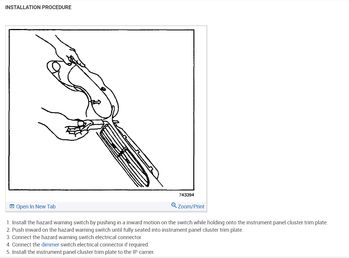

The Blinkers in my wifes vehicle have ceased working. They were working sporadically, but they have completely stopped as of this point. What might be the problem and how do I go about fixing this. Is it something that has to be done at the dealer or can I fix it myself? Thank you for all your help!
Tuesday, October 6th, 2009 AT 9:57 PM
KEN L
  • MASTER CERTIFIED MECHANIC
  • 48,363 POSTS
Nine times out of ten it will be the turn signal flasher. Here is how to change in in the images below.
