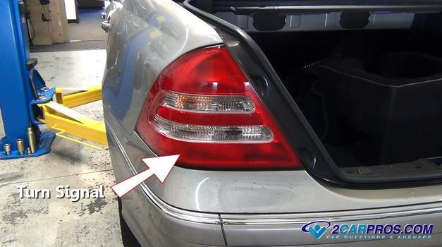

There are two different styles of bulb maintenance procedures, the first style requires the removal of the lens to access the bulbs while some manufacturers supply an access door which is the example we are using in this guide, additional configurations are featured in the videos below. First, identify the turn signal light (blinker) that has failed, inspect both front and rear bulbs to ensure the turn signal system is not the problem.

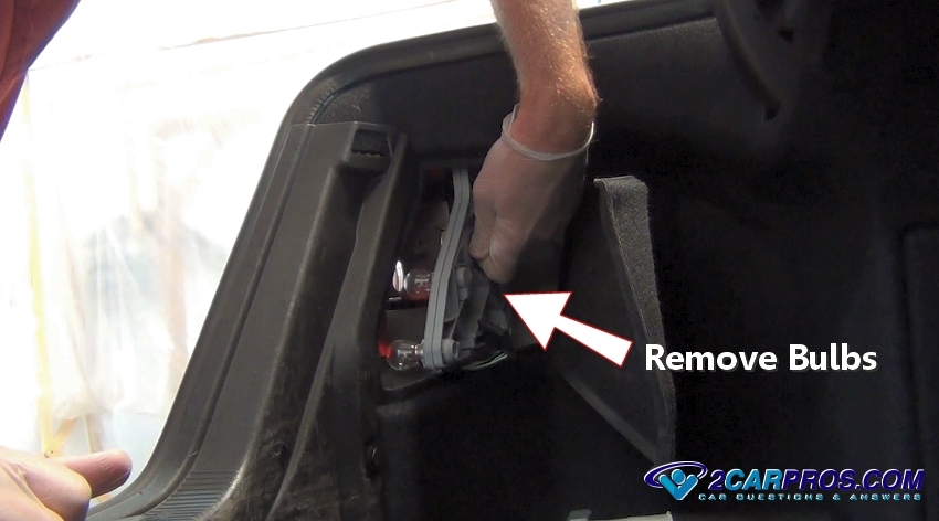

Grasp and turn the release fastener to pull the bulb housing plate from the lens, gently remove the bulb mounting plate which will expose the various bulbs including the turn signal, this configuration can be different depending on design.
remove turn signal bulb housing
Identify the failed blinker bulb, this failure is sometimes accompanied by a darkish color inside the bulb glass. While holding the plate down, gently grasp the failed bulb and twist counterclockwise while pushing down slightly, then pull up to remove, some bulbs just pull straight out.
twist to remove blinker bulb

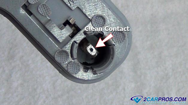

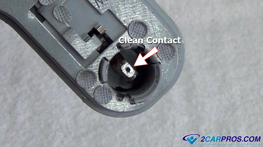

Once the bulb has been removed, inspect the bulb and socket for corrosion or damage, occasionally a bulb electrical contact can become overheated and burnt due a to high resistance of a poor connection, this will hinder the new bulb operation. Use a sharp object such as an Exacto blade or sandpaper to clean the contact by scraping the terminal exposing new metal.
clean bulb contact

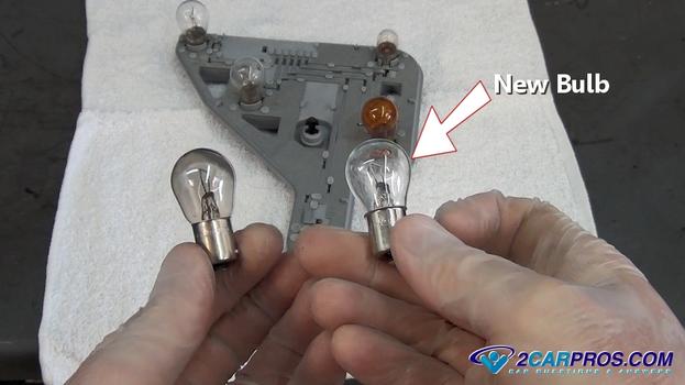

 Match the new bulb to the old unit, they should match identically, do not install incorrect bulbs this can cause lighting system electrical issues.
new turn signal bulb
It's important that the bulb terminals are the same, some bulbs are designed with two terminals which can cause operational problems if installed.
turn signal bulb single terminal

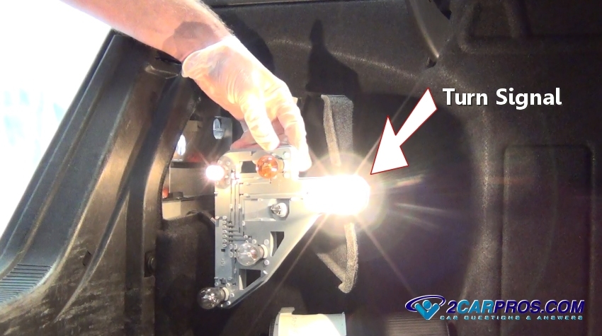

Turn the ignition switch on while engaging the blinker lever to operate the turn signal bulb ensuring the repair is done correctly and reassemble.
turn signal bulb
