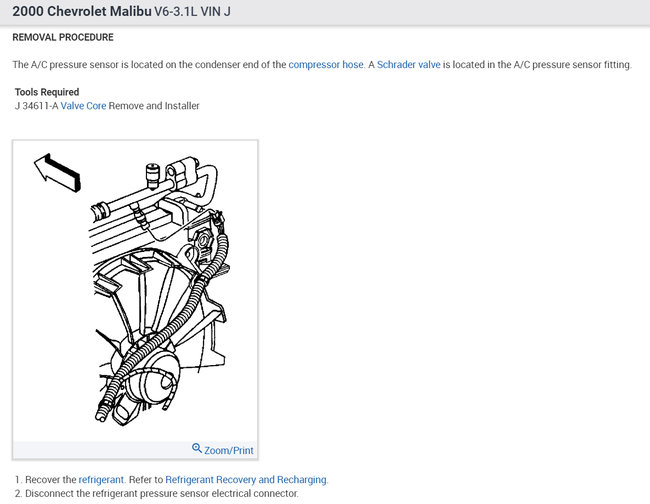

This sounds like the AC is low on refrigerant or you have a bad low pressure switch which will make the fans not run as well. Here is a video that can help see if the system is full.
https://youtu.be/uZrQCGwXfek
If its full here is the location of the low pressure switch which you can connect the wires together to see if the system comes on. Check out the diagrams (Below). Please let us know what you find. We are interested to see what it is.

I have a 2000 Malibu and I found the low pressure switch for it to be bad thanks to this guide. Cost me $42.00 for the sensor and the system works great once again! I love this site.
