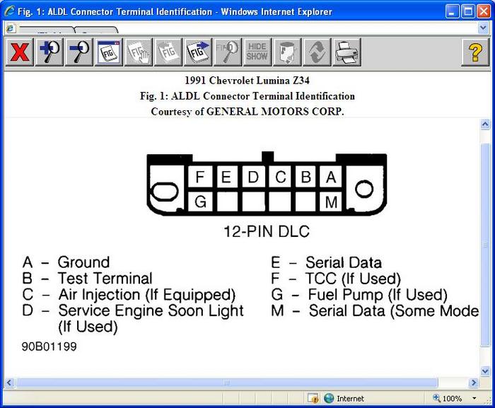

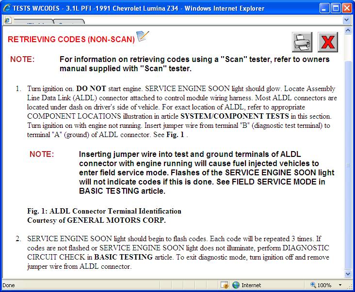

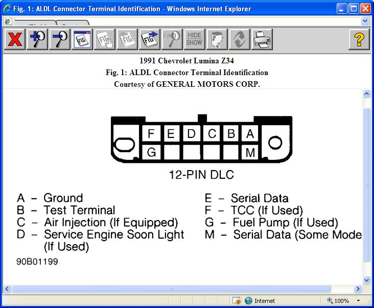

1991 chev lumina z34 when I start it up it idles fast and check engine light comes on. Drive it for about 15 sec. Idles down, light goes out. Whats my problem?

Let's start with what code's do you have?
Monday, January 9th, 2017 AT 4:03 PM (Merged)
JDL
  • 16,098 POSTS
Check mil codes. You can check them yourself. Place jumnper wire between A and B terminals of datalink connector. Turn key to on, no crank, the mil starts flashing, you count the flashes to get the codes. Your looking for two digit codes.
Also, take the throttle-body off and clean it, check idle air, With idle issues.
SATURNTECH9
  • 30,869 POSTS
I posted how you can get your code's without a scan tool.

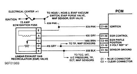

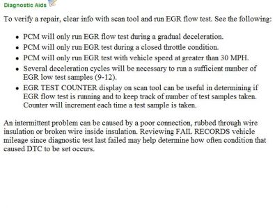

1996 Chevy Lumina 6 cyl 188000 miles
After starting car (with cold engine) the car idles fast, I usually leave the car at high idle for a couple of minutes, and the only way to slow the idle is to shut the car off, then turn it back on. If the car is ran for a while (10-15 miles) and you shut the car off for 1-2 hours the idle is normal, if the car is off for any lengh off time 8 hrs to overnight, and I start it it has high idle. The check engine light is on, a mechanic checked codes and said the egr valve is bad, but this is the only code, and did not know what would cause a high idle without alot of labor (money), he suggested just keep turing car off. This is my 16 year old daughters car, I would like this to work. Do you have any suggestions?
ZACKMAN
  • 4,202 POSTS
EGR valve can cause a very high idle, but I don't like to replace any parts unnecessarily. For proper diagnostic, we would like to have the trouble code number from the check engine light. Do you have it or can you get it from the mechanic? If you can't, drive the vehicle to your local Autozone and have them scan the computer for codes. Post the codes here and we'll troubleshoot.
D***W
The code for the check engine light is P0401.
ZACKMAN
  • 4,202 POSTS
https://www.2carpros.com/forum/automotive_pictures/55316_96luminap0401_1.jpg
https://www.2carpros.com/forum/automotive_pictures/55316_96luminap04012_1.jpg
https://www.2carpros.com/forum/automotive_pictures/55316_96luminap04013_1.jpg
https://www.2carpros.com/forum/automotive_pictures/55316_96luminap0401_2.jpg
Do not replace the EGR valve, just yet. You need to do the diagnostic first, and you may also want to check for clogged EGR port and line, PCV operations, EVAP canister purge solenoid, and MAP sensor.
