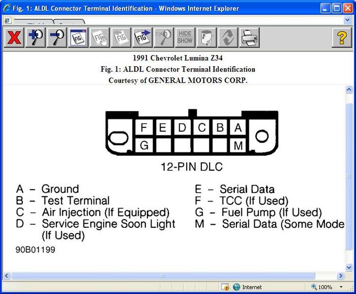

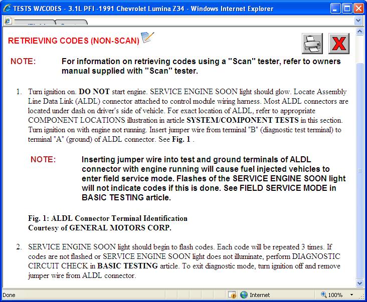

Try to retrieve code/s from the computer by jumping terminal A to B on the DLC. I recommend you clean out the IACV and see what happens to the idle
Jan 9, 2017 at 8:03 AM
(Merged)
Thank you kindly for the great info. I cleaned the IACV and the idle problem seems to have been resolved for now.

Let's start with what code's do you have?
(Merged)

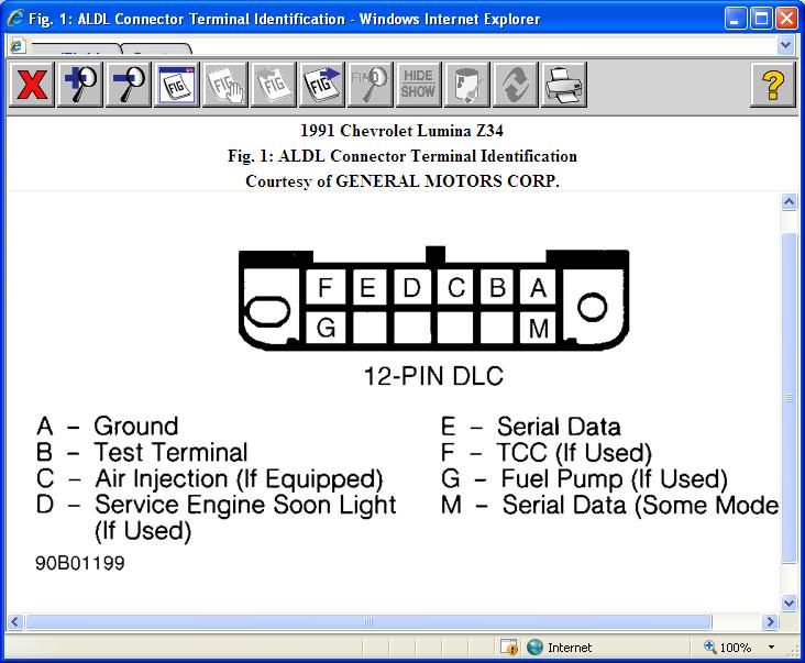

Check mil codes. You can check them yourself. Place jumnper wire between A and B terminals of datalink connector. Turn key to on, no crank, the mil starts flashing, you count the flashes to get the codes. Your looking for two digit codes.
Also, take the throttle-body off and clean it, check idle air, With idle issues.

I posted how you can get your code's without a scan tool.

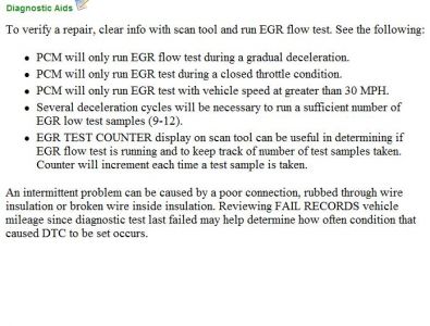

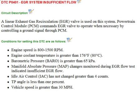

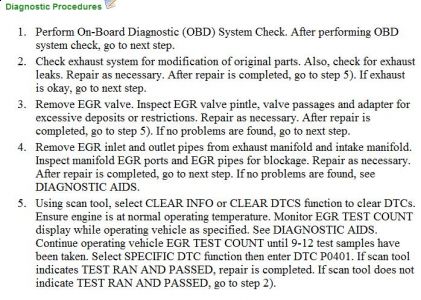

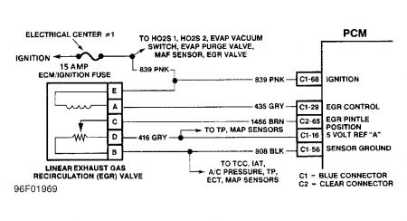

EGR valve can cause a very high idle, but I don't like to replace any parts unnecessarily. For proper diagnostic, we would like to have the trouble code number from the check engine light. Do you have it or can you get it from the mechanic? If you can't, drive the vehicle to your local Autozone and have them scan the computer for codes. Post the codes here and we'll troubleshoot.
(Merged)
The code for the check engine light is P0401.

That's OK. Just make sure that they do more than simply replacing the EGR valve, as that will not fix the problem.
