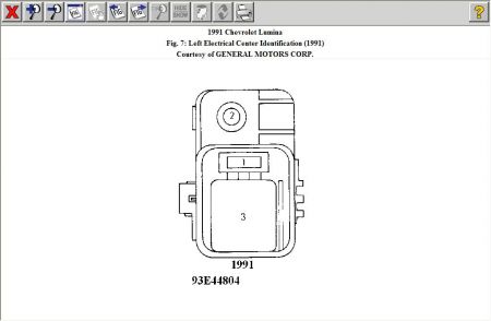

KHLOW2008
  • 41,814 POSTS
Hi DoratheExplorer,
Just want to confirm a few things.
Does the warning chime comes on ONLY when headlights are ON? With or without ignition switch ON or engine running?
The ECM fuse in underhood left electrical center is rated as 20 A, item # 1 in diagram. It is also for the fuel pump and since you have a 10 A fuse, it would blow as it does nt have the capacity to run the fuel pump for extended eriods.
https://www.2carpros.com/forum/automotive_pictures/192750_FuseBox91Lumina02_1.jpg

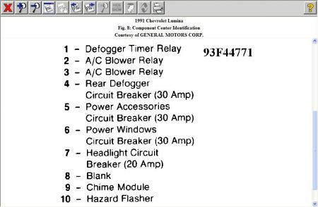

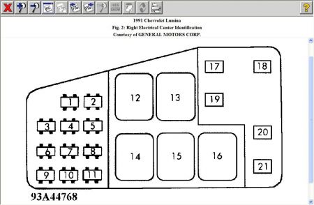

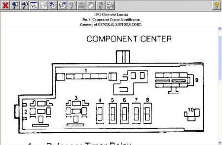

DORATHEEXPLORER
  • 46 POSTS
Here's apicture of the fuse box (passenger side, under hood). The fuse that keeps blowing is the distributor fuse (10amp). Also, could you tell me what all the other fuses to the right are for. There are 3 60amp & 3 30amp. The one that's x'd out says fuel pump relay, but it's empty and the fuel pump/ecm relay is actually on the drivers side of the car. Figured out the dinger noise. Was simply a fuse in the glove box panel. DUH!

KHLOW2008
  • 41,814 POSTS
I could not see any diagram and have instead posted 1 with the identifications.
Let me know which fuse is blowing and I will try to get the details.
https://www.2carpros.com/forum/automotive_pictures/192750_FuseBox91Lumina01_2.jpg
https://www.2carpros.com/forum/automotive_pictures/192750_FuseBox91Lumina01a_1.jpg
