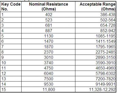

JDL
  • 16,098 POSTS
If you have the pellet in the key, check resistance. If it doesn't check out, replace the key.
http://www.2carpros.com/forum/automotive_pictures/170934_passkey2_1.jpg
Thursday, December 10th, 2009 AT 1:05 PM
DBENTZ314
I will check the key. How do I know the key code? And do I measure resistance between the key and the metal on the pellet?
Friday, December 11th, 2009 AT 12:08 PM
JDL
  • 16,098 POSTS
Check the resistance from one side of pellet to the other, note the reading, find it on the chart.
