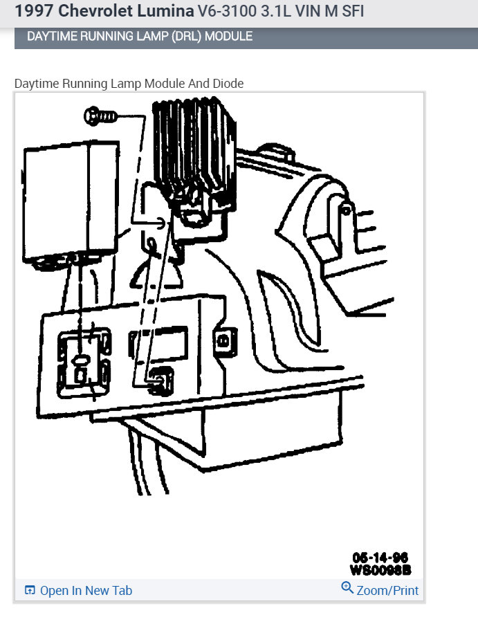

How can I turn off the headlights when the car is running. I can't put the parking lights on or anything. If the car is running the headlights are on, WHY. At night when driving up to a guard gate I cant turn off my lights. They get mad and tell me to turn off my lights or put the parking lights on. GOT ANY Idea why the lights stay on and can this be fixed ?

It sounds like the DRL module is out here is the location so you can change it out. Check out the diagrams (Below). Please let us know if you need anything else to get the problem fixed.

Thanks for this post I had to get anew DRL module cost me $98.00 all fixed. I love this site.
