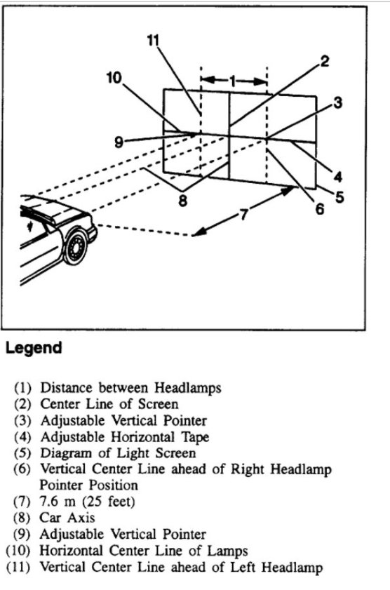

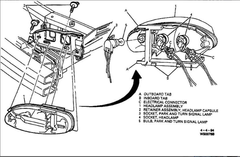

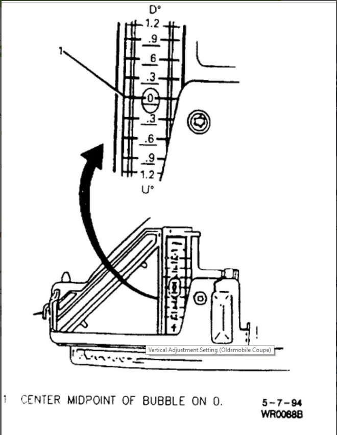

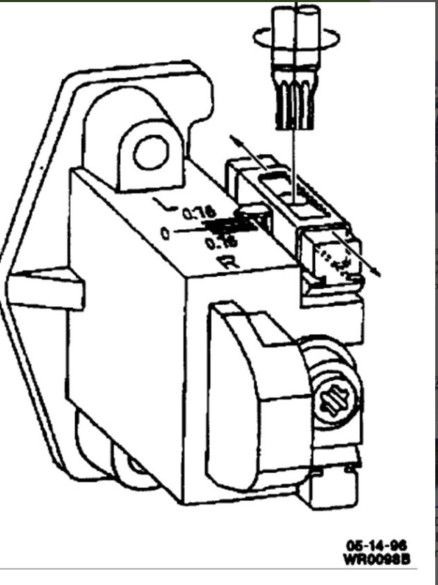

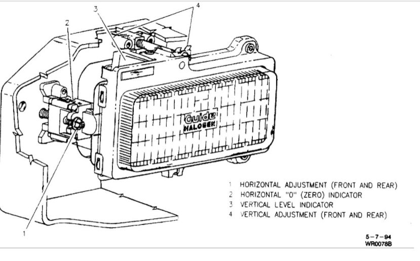

How do I adjust the headlights up or down?. Right now they are shinning at the top of trees instead of on the road.. and do I need any special tools to adjust them?
Dec 1, 2009 at 5:46 AM
No problem. You don't need any traditional special tools, but you will need a set of torx bits. Also, I believe you will need inverted torx as well.
Here is a guide that will help with changing the bulbs in case you need it:
https://www.2carpros.com/articles/headlight-lens-replacement
Please see the info attached below that will include the in needed. Unfortunately, it does not have the size of the bits but if you have a basic set, it will be included.
Let us know if you have questions on this.
