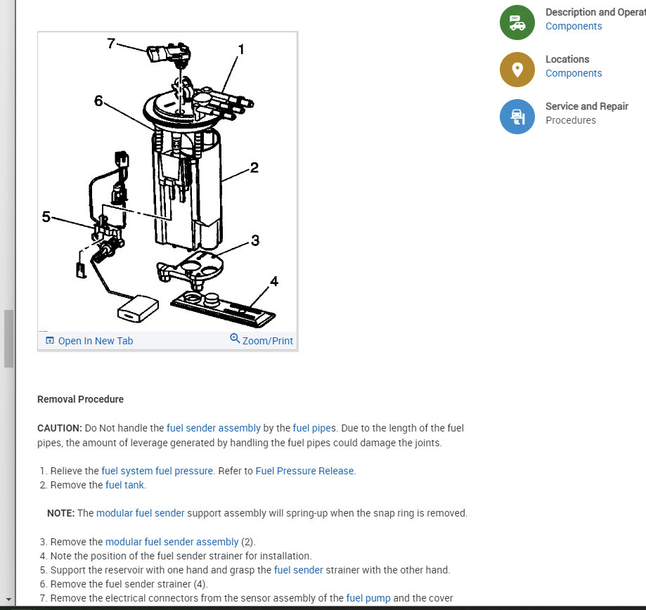

Chances are the float is bad in the tank. It is a simple device that uses a rheostat to adjust the amount of power that gets sent to the gauge to tell you how much fuel is in the tank. The bad part is you need to remove the fuel tank to access it and it is part of the fuel pump which makes it expensive.

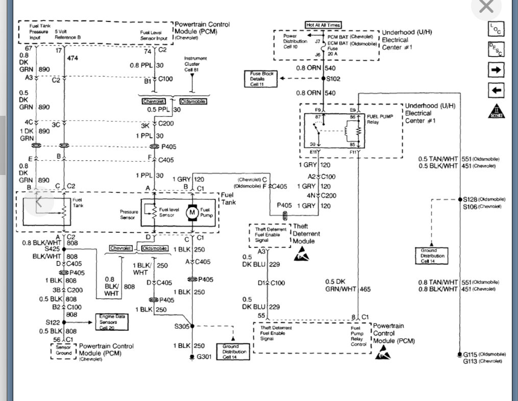

Just to be clear, this started after you replaced the pump or did you replace the pump to address this?
If this was after the pump replacement, then I suspect we have an issue with the replacement pump.

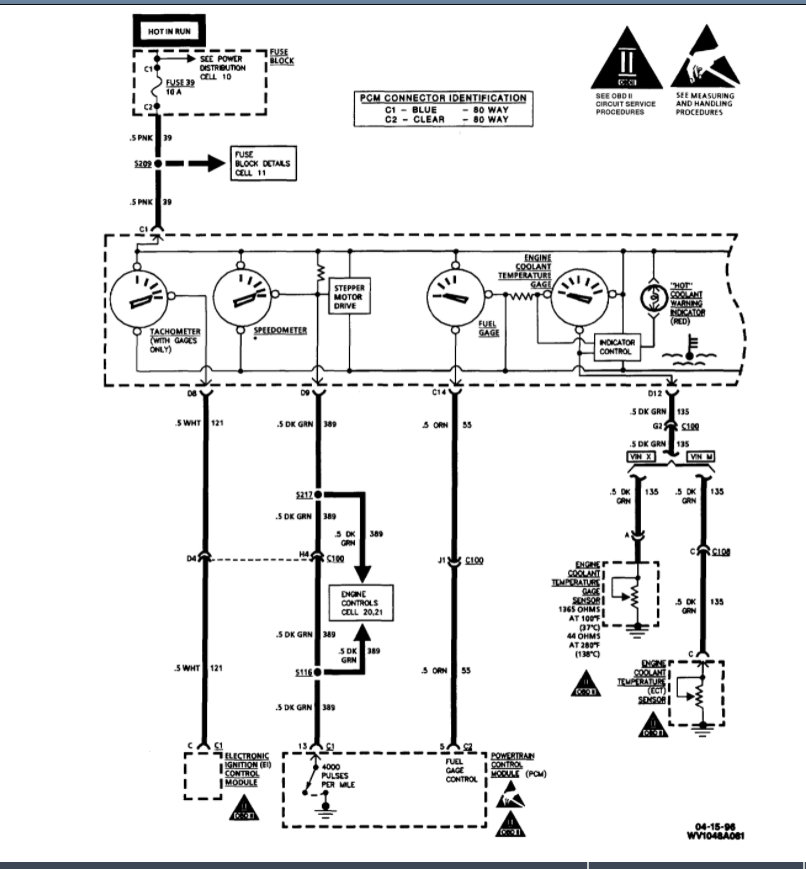

However, if this was the issue prior to it then the way this works is the PCM tells the gauge what the fuel level is. So, we should check and find out what the PCM is telling it to find out if this is a gauge issue. Basically, if the voltage is fluctuating then the gauge is just displaying what it is told.
If it is remaining constant, then the gauge is the issue.
I am attaching the wiring info below so let's start with this and go from there.
Thanks

Great answer. I wish I knew more about electrical issues. The diagram is a little cryptic to me, but I'll figure it out. Thanks for the info.

Was this a new pump? If you never noticed this gauge issue, then I suspect the sensor that is attached to the float arm is faulty. Basically, I have learned over the years, new parts are not good parts. So, you can replace a part and get an entirely new issue.
Any time this happens the normal cause is the part you just replaced.
