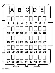

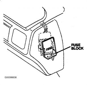

All my gauges are not working. The speed odometer, fuel, temp etc won't register. Is there a fuse that controls all these gauges and where is it?
Apr 30, 2009 at 3:34 PM
ZACKMAN
  • 4,202 POSTS
Inside the fuse block, fuse 39, 10A.
