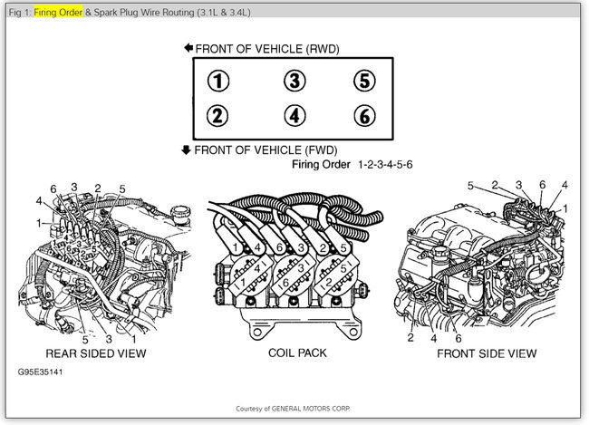

RHONDA BARA
  • 1997 CHEVROLET LUMINA
Six cylinder two wheel drive automatic 135,000 miles.

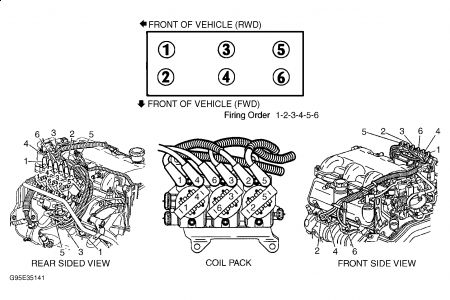

Need a diagram for firing order spark plugs.
Monday, July 20th, 2009 AT 2:22 AM
13 Replies
MHPAUTOS
  • 31,937 POSTS
Hi there,
Firing order. See pictures for details.
mark (mhpautos)

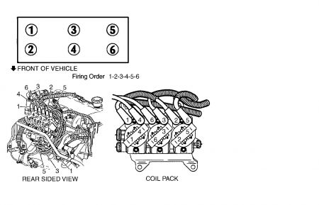

JDL
  • 16,098 POSTS
https://www.2carpros.com/forum/automotive_pictures/170934_31_1.jpg
I found that in a database for the 3.1
firing order 123456
Monday, January 18th, 2021 AT 8:43 AM (Merged)

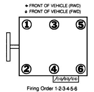

BMRFIXIT
  • 19,053 POSTS
https://www.2carpros.com/forum/automotive_pictures/99387_31firing_order_1.jpg

Here is a guide on how to change spark plugs for anyone that needs it.
https://www.2carpros.com/articles/how-to-change-spark-plugs
Here is the firing order for you car
Firing Order 1-2-3-4-5-6
Check out the diagram (below)
