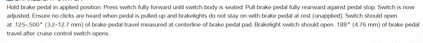

The picture is the brake pedal switch, it is activated by the brake pedal arm. You have to follow the brake pedal arm upward to find the switch.

brake light switch replaced still no brake lights but the center one

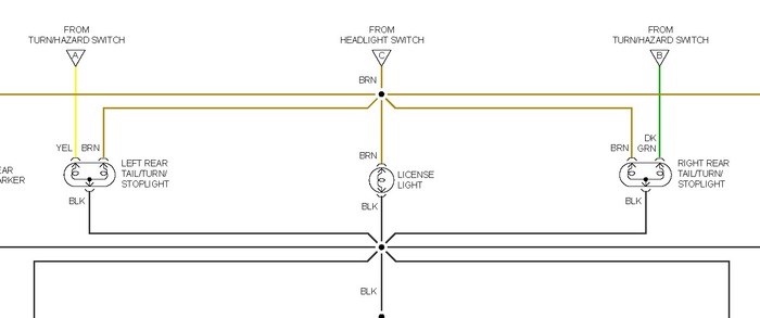

Replace the combination switch in the steering column. The 2 lower brake lights pass through is so the turn signals can cancel the brake lights when necessary.

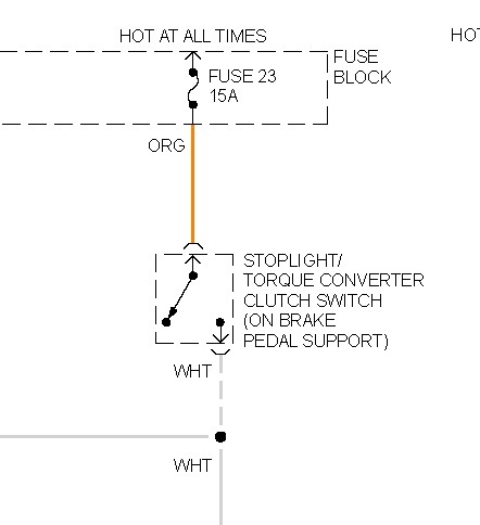

Well i didnt have the tool on hand to test the voltage of the brake switch but the part was only a few dollars so I bought and replaced it tonight. However it did nothing to correct the problem. Knowing that the switch is indeed not bad where should i look next?

Do voltage test.
