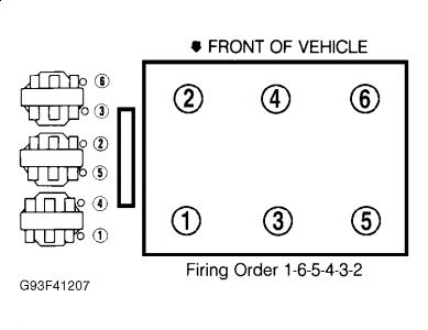

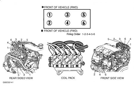

Wires to the distributor are crossed from the spark plugs! Where do I start?

Hi there, check pics for your engine type.
