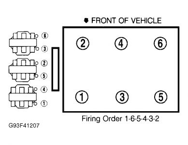

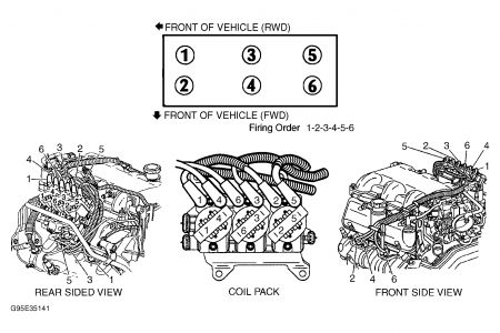

I was changin the wires from the distributor cap and mixed them up now the engine is miss friring how do I figure out how they are supposed to go

The Diagram is for the Lumina Van 3.1L.....

Should have a coil pack for 3.1 and 3.4 and three coils for 3.8
