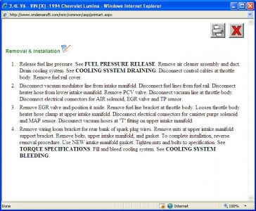

I have an intake leak in my 94 chevy lumina z34. 3.4 dohc automatic and im going to attempt to correct that by replacing the spark plug wires and the upper plenum gasket. The haynes manual suggest removing a lot of parts but it all doesn't seem so necessary. Should I apply any gasket material or sealant besides a replacement gasket?

https://www.2carpros.com/forum/automotive_pictures/416332_1994_chevy_lumina_3_1.jpg
That's what i have on replacing it you just need to replace the gasket no sealer.I also emailed the step's to you.
