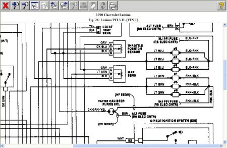

  • 75,992 POSTS
Disconnect the wiring harness at the ECM and Injectors now do a continuity test between the 2 the only way to have power at both wires is -its shorted together-one injector with shorted wire will bring down the rest-
Monday, March 31st, 2008 AT 7:56 PM
  • 75,992 POSTS
Below is your circuitry
The light blue wire is the ground circuit that the computer uses to drive it off and on the black and pink is the hot circuit to the injector should have this power when key at on
https://www.2carpros.com/forum/automotive_pictures/12900_injectors_wiring_1.jpg
