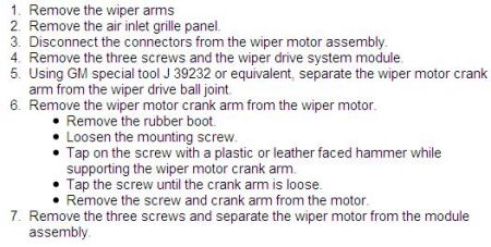

can you tell me how to replace a windshield wiper motor

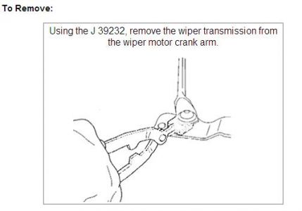

If you don't have the special tool, that is listed, you might be able to use something similar. I've only given you the removal procedure, there is an install procedure as well.
