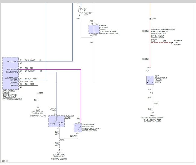

The dome/entry lights arent working properly. The 2 at the driver's and passenger's feet turn on and work fine but the 2 in the rearview mirror and the 2 above the back doors dont turn on or work at all. My assumption is that it is a fuse but I dont know which one it is if it is a fuse and not something else. How do I fix this?

Hey Guys,
It looks like it could be the battery run down relay or the BCM here is a wiring diagram to help you test for the problem.
Run some tests and get back to us so we can continue helping you.
Best, Ken

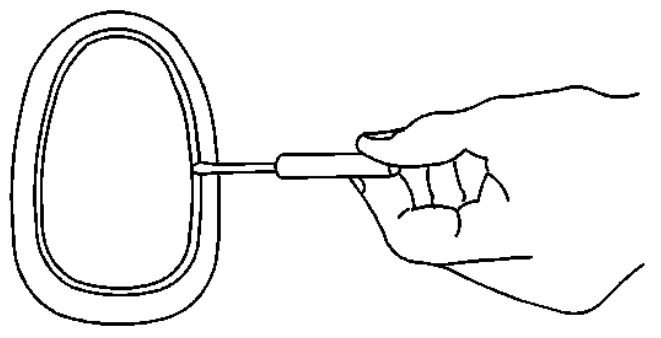

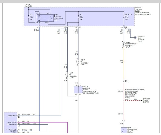

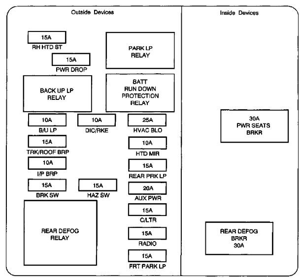

MASTERWRENCH
  • 258 POSTS
I would start by removing the dome lamp lens and checking the bulb to make sure it isn't blown. The lens is removed by inserting a small screw driver in the tab and gently prying it off (see attached picture). If the bulb is good, l suggest checking the fuse. In this case, the fuse is located in the fuse panel on the right side end of the dash. The one you're looking for is labeled TRK/ROOF BRP (see attached diagrams).
Let us know what you find!

on the left side dash fuse panel there is a fuse labeled:
a/c cruise
you may want to look into that being loose or a wiring issue in or around the fuse box.
