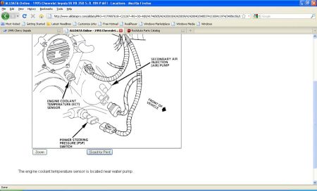

were are the coollat sensor located at there are two of them

There is only one sensor and it's for the computer (in image). the other one is a sender/switch and it's for the temp gauge. That one is located above the starter.
https://www.2carpros.com/forum/automotive_pictures/561653_Coolant_temp_sensor_95_Impala_57_1.jpg

https://www.2carpros.com/forum/automotive_pictures/416332_1995_chevy_impala_ss_coolant_temp_sensor_1.jpg
There you go.
