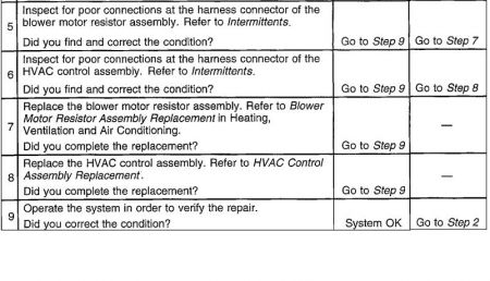

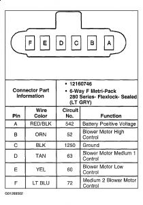

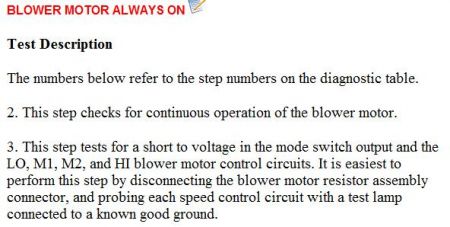

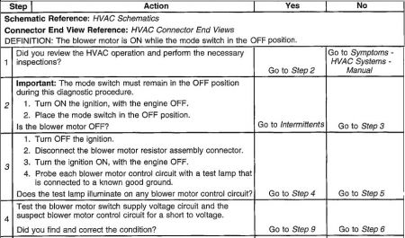

The heater blower goes on by itself both while driving and while parked. The only way to turn it off when this happens is by disconnecting the wires on the unit against the firewall (next to battery).
