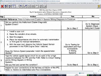

We have a 2002 Chevy Express work van w/ 5.7 auto trans. Came in from the airport on Friday night and noticed and burning electrical smell. Looked down and noticed the speedometer and the odoemeter were not working but the rest of the cluster was fine. Later noticed that the brake lights, dome light and radio also quit working. Van runs fine though. All fused in kick panel are ok. Checked 50amp BAT fuse under hood and it was blown. Replaced it and blew immediately. Checked under dash and can't find and burnt wires. Where do I look? Is this a common problem? Please help because I cannot go to work without this van. Thanks, Dustin.

I just need to know if this appears to be a problem with these vans. I am very experienced with auto mechanics and am willing to do the work. I noticed that there appears to be a lot speedometer issues with the GM line and I didn't know if this may be one of them. Do you have any ideas where to start? Is is most likely a harness plug that includes the speed sensor, brake lights, dome light and radio? Are they on the same circuit somewhere down the line? The only fuse blowing is the 50amp BAT under the hood. What is it's function? There is no owners manual with this van, so I cannot trace the fuse.

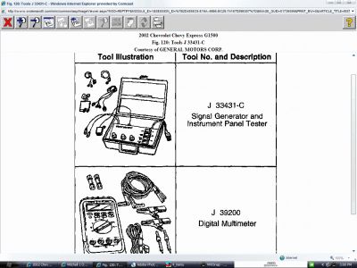

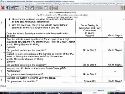

It's likley to be the cluster, they do go bad frequently, but to know for sure, this is the test equiptment needed, and the test steps...or take a shot!

If you do swap it out, plug the new one in, turn key on for ten minutes to initialize it, then remove key, should now be good to go.
