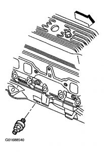

Let me see if I remember correctly: is the catalytic converter part of the egr system? I cleaned the upper end of the egr system and have the same results.
Tuesday, October 19th, 2010 AT 11:44 AM
  • 109,874 POSTS
I want you to remove the knock sensor and inspect it. It is on the right side of the motor.
https://www.2carpros.com/forum/automotive_pictures/249084_5_88.jpg
Let me know its condition.
Tuesday, October 19th, 2010 AT 1:42 PM
SMETZ
  • 16 POSTS
Right side as in passenger side?
Tuesday, October 19th, 2010 AT 1:58 PM
SMETZ
  • 16 POSTS
Am I to take it completely from the block or just unhook it? I loosened it and oil started coming out. Will I lose a bunch of oil? If I remove it from the block, to I clean it out with carb cleaner to inspect?
Tuesday, October 19th, 2010 AT 2:26 PM
  • 109,874 POSTS
You won't loose a lot.
Tuesday, October 19th, 2010 AT 9:51 PM
SMETZ
  • 16 POSTS
Ok, I did not check it because I was waiting for a reply and it is dark out now. But I had a thought about looking at my ignition system in the dark. It looked like a christmas tree. I saw two for sure arcs in the plug wires. But it seemed to me that all of the wires were lighting up (seemed like inside the wire) all in the same places, for example where they might be near another wire but not touching. This was at idle. When I gave it some throttle it seemed as if it would go away in all places. Are the wires bad if they light up like that? I have tested my ignition stuff like this before, but never remember seeing wires act like that.

  • 109,874 POSTS
Oh my god. That is the problem. You shouldn't get any arcing.
Wednesday, October 20th, 2010 AT 8:01 AM
SMETZ
  • 16 POSTS
So what makes the wires light up internally? I have never seen this before. And should I have been able to see the spark plugs lighting up too? Maybe I was just seeing the glow through the porcelain I dunno. I could not see all the plugs to make sure that it wasn't just the ones I was seeing, which was two out of two. I think the wires are still under warranty, hopefully they will let me swap and pay the difference for better ones.
Wednesday, October 20th, 2010 AT 10:49 AM
  • 109,874 POSTS
You are seeing the spark from the ignition system. You shouldn't see any at all. The only place there should be spark is inside the engine at the end of the spark plug. You are losing all the power from the arcing.
