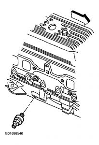

  • 110,244 POSTS
I want you to remove the knock sensor and inspect it. It is on the right side of the motor.
https://images.2carpros.com/forum/automotive_pictures/249084_5_88.jpg
Let me know its condition. Joe

SMETZ
  • 16 POSTS
Right side as in passenger side?
Oct 19, 2010 at 6:58 AM
SMETZ
  • 16 POSTS
Am I to take it completely from the block or just unhook it? I loosened it and oil started coming out. will i lose a bunch of oil? If I remove it from the block, to I clean it out with carb cleaner to inspect?

  • 110,244 POSTS
You won't loose a lot.
