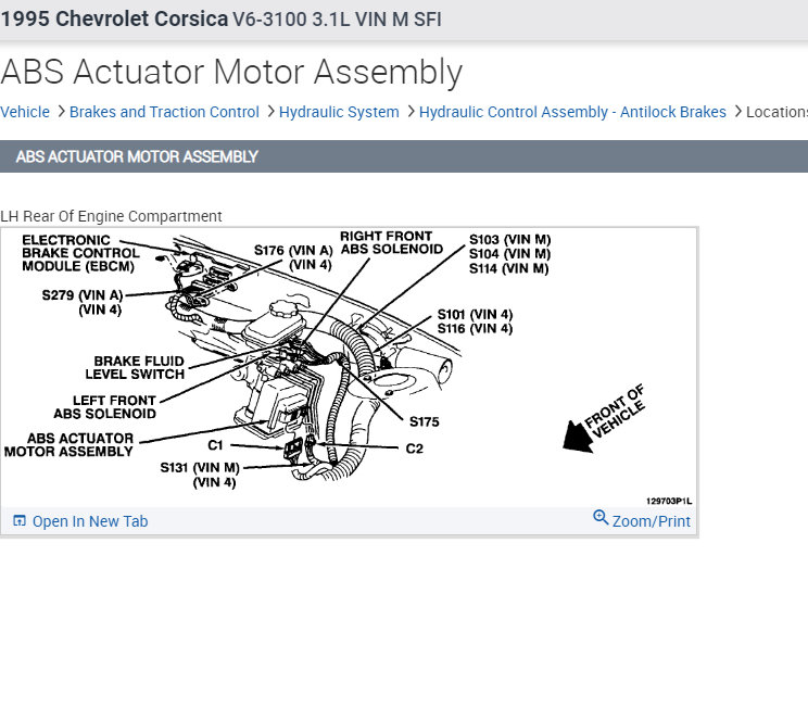

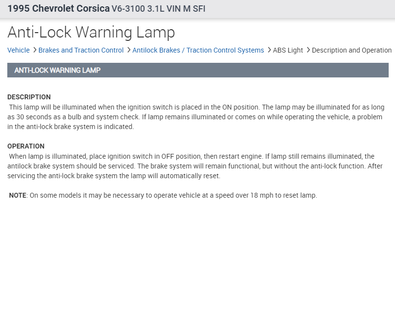

when i start the car the abs light comes on and the radio seems to fade in/out plus there's a constant clicking what is possibly
causing these things.
Jun 27, 2008 at 4:32 AM
SQM
  • 6,383 POSTS

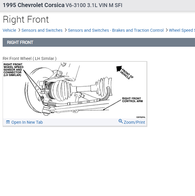

The ABS light gets triggered when the ABS system detects any fault within.
It could be due to a faulty sensor, bad wiring or the module.
https://www.2carpros.com/articles/abs-warning-light-on-easy-repair-guide
The best course of action would be to scan and retrieve the ABS code(s). That can help with the diagnostics of what might be triggering the light.
