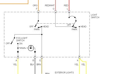

1995 Chevy Corsica 4 cyl Front Wheel Drive Automatic
check fuses check realeys nothing work what alse can i do
Aug 6, 2010 at 7:19 AM
JDL
  • 16,098 POSTS
If the headlites won't work, check the wiring connector at the headlamp switch, red wire is voltage, use a voltage tester, hot all the time. The yellow wires bottom right, goes hot/voltage when you turn on the headlamp switch. If that checks out, check the feed to and from the dimmer switch.
https://images.2carpros.com/forum/automotive_pictures/170934_corsica_headlamp_switch_1.jpg
