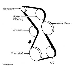

need a diagram on how to route a serpentine belt

Look on google image and there about 400 pics of belt route

Heres aphoto

How do you replace the serpentine belt that turns all the accessaries? What do I need to do?

push tensioner away from the belt and remove it
