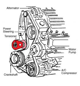

How do I replace my serpentine belt. The pulley on top has a motor mount does it have to be removed and if so does the motor need to be supported??

Locate the tensioner and lift away from the belt Be sure to draw how the belt is routed if there is no under hood sticker showing it
https://images.2carpros.com/forum/automotive_pictures/99387_Graphic1_95.jpg
Read the guide below, its not vehicle specific, but it will help https://www.2carpros.com/articles/replace-serpentine-belt

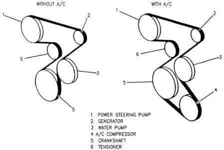

Let me know if your engine size is different than 2.2L 2.2L Engines:
https://images.2carpros.com/forum/automotive_pictures/261618_0900c152800a7034_1.jpg

What is the length of the belt without ac compressed bearing fried so don't need ac was gonna put belt on and need to know length without ac

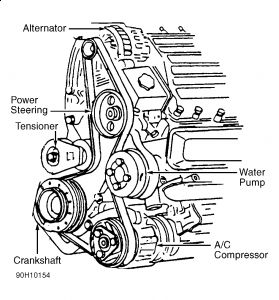

I need a printout that shows how to replace the belt on the engine

check the diagram below locate the tensioner and pull away from the belt pull belt
https://images.2carpros.com/forum/automotive_pictures/99387_corsica_1.jpg

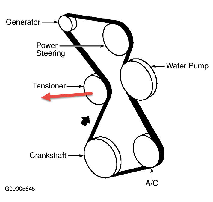

I started the car this morning and heard a strange clicking kind of noise. Thought a bird got caught in the belt or something. Then realized I had no power steering. Looked under the hood and the belt is so way loose, but not broken. How do I tell if its the belt or the tensioner. The belt is real loose. It's old but not frayed. Some cracks in it. Could it have stretched that far? How can I tell if it's a bad tensioner?

WRENCHTECH
  • 20,761 POSTS
If it's the correct belt, routed correctly and none of the pulleys are bad, then all it can be would be the tensioner.

my drive belt is going bad, and i have been putting oil on it and it slipped off and now i cannot figure out how to release the tensioner on the belt.
Nov 19, 2018 at 5:36 PM (Merged)
HMAC300
  • 48,601 POSTS
worse thing you can do is to put oil on a belt. clean all the pulleys with choke cleaner or brake clean then replace the belt and tensioner. see picture arrow shows which way to move tensioner.

how do i move the tensioner?
HMAC300
  • 48,601 POSTS
i already showed the direction in first reply with the picture move it in the way of the red arrow.
KOLEC94
  • 18 POSTS
ok so i have to unbolt the tensioner?
HMAC300
  • 48,601 POSTS
only if you replace it which you should due to age and replacing belt as well.

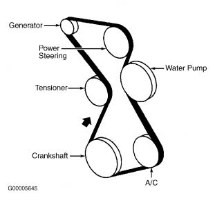

How do you replace the serpentine belt that turns all the accessaries ? What do I need to do?
BMRFIXIT
  • 19,053 POSTS
https://images.2carpros.com/forum/automotive_pictures/99387_corsicabelt_1.jpg
push tensioner away from the belt and remove it
