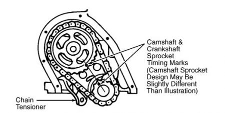

how do you get cam and crank realigned after timing chain breaks with no marks on cam gear

Unless you installed the gears backwards there should be small dots on the gears. I'm sending a picture along so you can see what i mean. just align them like the picture and you are good to go, at least if you put the other stuff in as well. I would reccomend replacing the chain tensioner as well......
