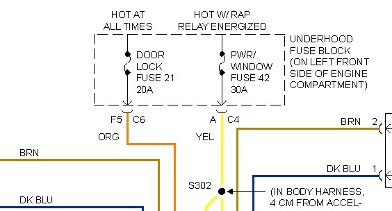

I left my key on in my truck accidently, now that i have jumpstarted the battery, the driver window and the locks do not work, i know there is a way to reset this but i don't remeber how, could you help me with this?

According to Mitchelle it takes a scan tool to go in and relearn the bcm. How ever the widow and lock on not on the same circuit but they do share fuse 21 for power. Also according to mitchelle there is no reset required for battery replacement. Check fuse 21 first and if that is good then you will need to have the bcm scanned to reprogram it.

If the fuse is good, you most likley have a bad driver window switch. I have had many of them go bad after jump starting or battery replacement. There is something inside them that gets a voltage spike and it kills the module.

Does any of the other functions work from the remote, indicating it is at least functional, or are there any other than door locks. It looks like your left front door switch is also the door module. It controls door locks and the left front window only. Try removing the door lock fuse(#21) in the underhood fuse block for a few minutes. This supplies power to the logic portion of the door module. The fuse is good, correct? Also check if it has power to/across it. Since the door locks don't work with either the switch or keyless, I don't suspect a fault with the body control module, which is also the keyless receiver. I am suspecting logic lock on the drivers door module. When you reinstall the fuse it may work. Logic lock does not necessarily indicate a failure of the component, just a tie up, perhaps from a voltage spike due to the shorting of the battery.

If you checked the fuses, you can check power and ground at the window switch. Try disconnecting and shorting both battery cables. This does about the same as before, but on a broader spectrum. After that and still with no success, you will probably need a scan tool to verify inputs are being received by the drivers door module(switch). If the inputs are being received, yet no outputs are being executed, you could have a faulty drivers door module.

You can check some of the wiring going into the driver door on the hinge side of door. The wire harness may have a rubber boot protective covering, pull the covering back. Orange wire is voltage for door lock. Yellow wire is voltage for power window. Check for voltage on those wires, use voltage tester. Black wire is ground. You can also check fuses.
