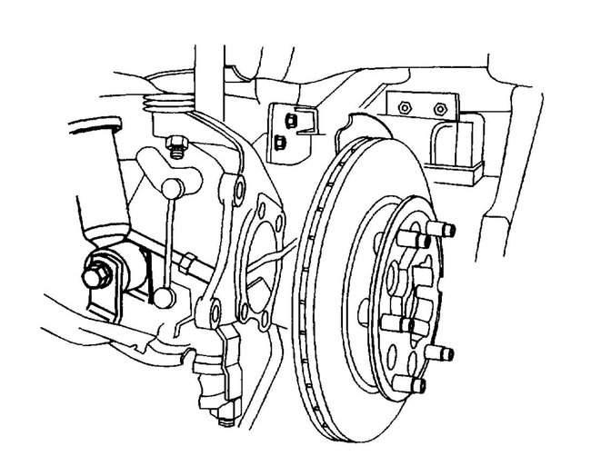

had it checked for abs fault coming on every 2 or 3 times I drive it dealer said it was speed sensor / axle bad I was wondering if I could fix it myself without changing axle
Tuesday, March 9th, 2010 AT 7:15 PM
16 Replies
HMAC300
  • 48,601 POSTS

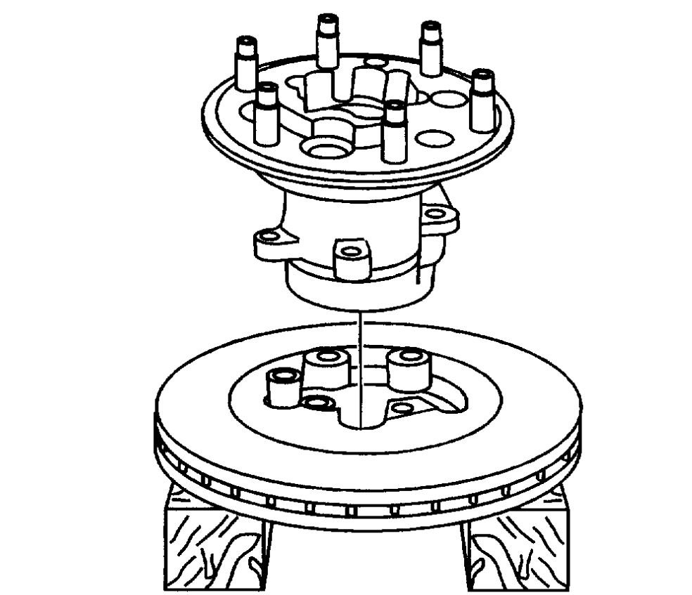

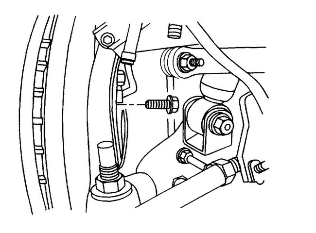

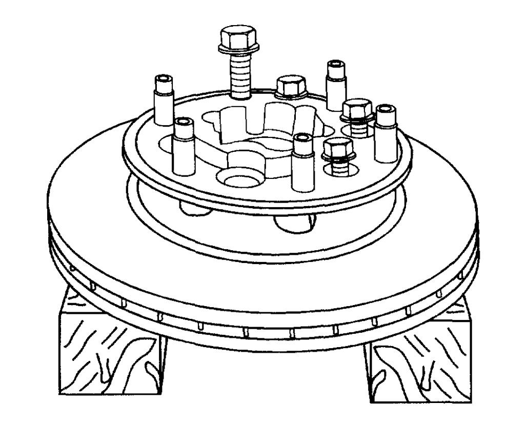

The sensor on these look to be part of the hub. You will have to replace the entire unit. The ABS system will need to have the codes cleared before it will work again
Check out this guide, it will show you what to do
https://www.2carpros.com/articles/how-to-replace-an-abs-wheel-speed-sensor
See the diagrams below
