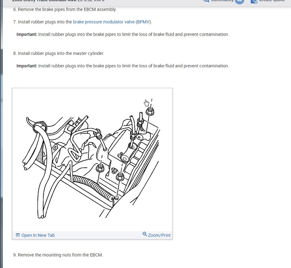

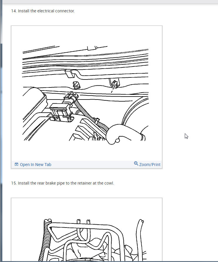

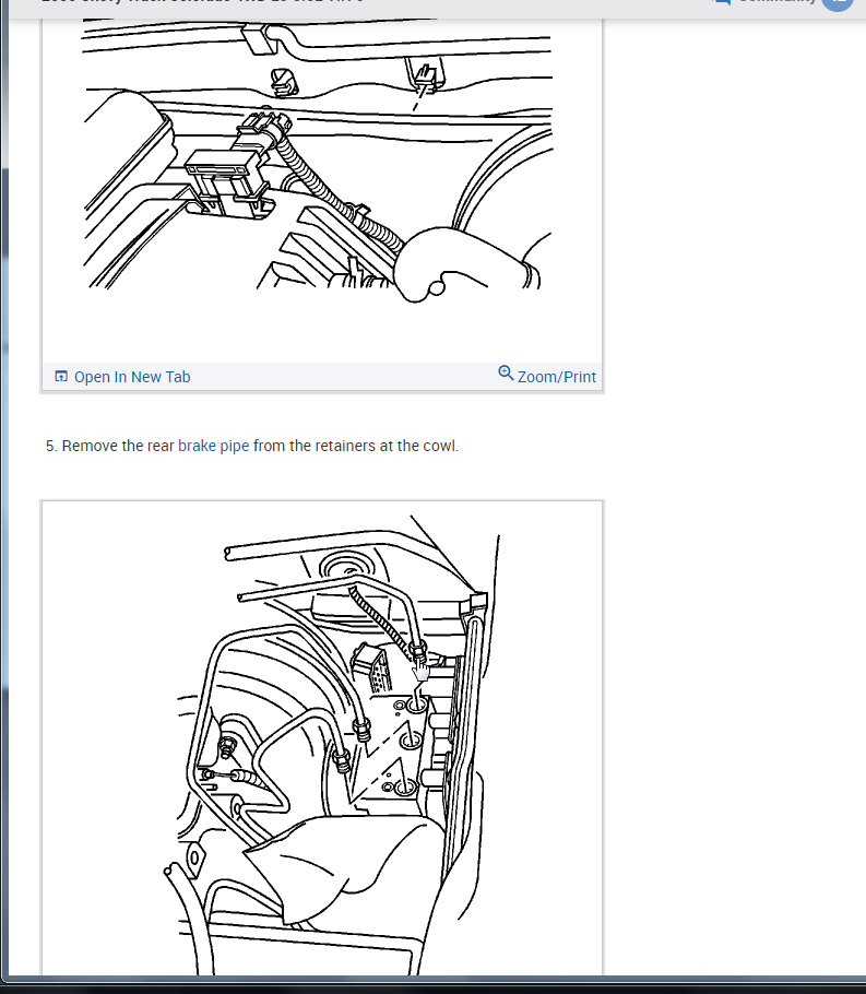

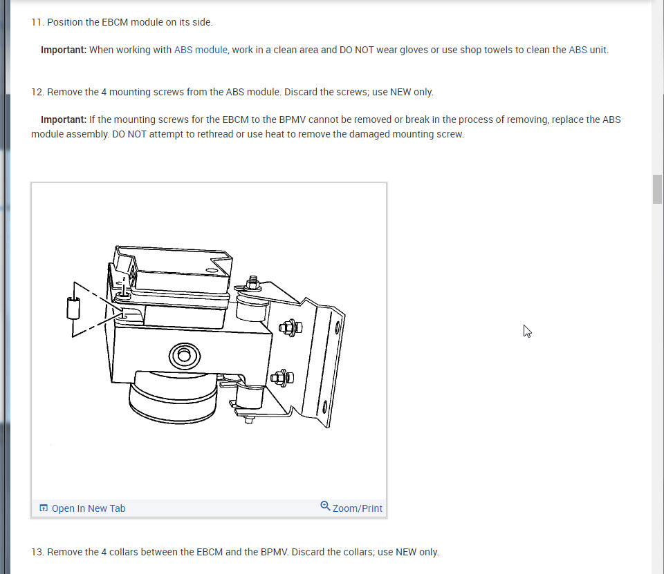

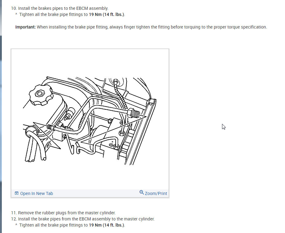

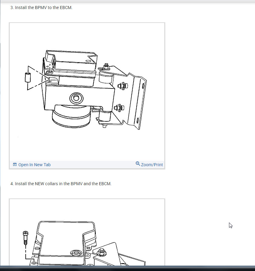

My ABS goes activates on dry roads?
2006 CHEVROLET COLORADO
ROD649

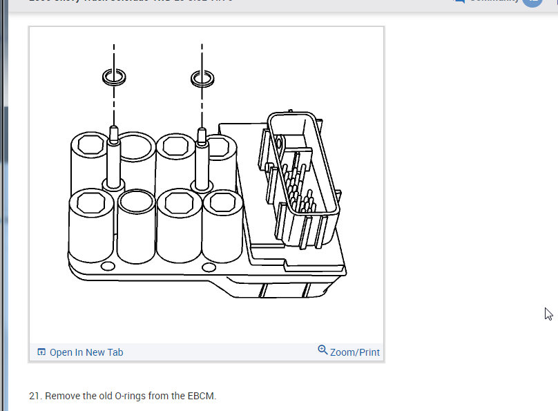

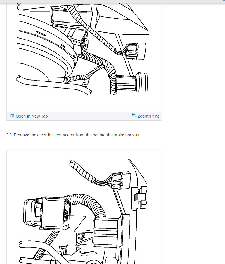

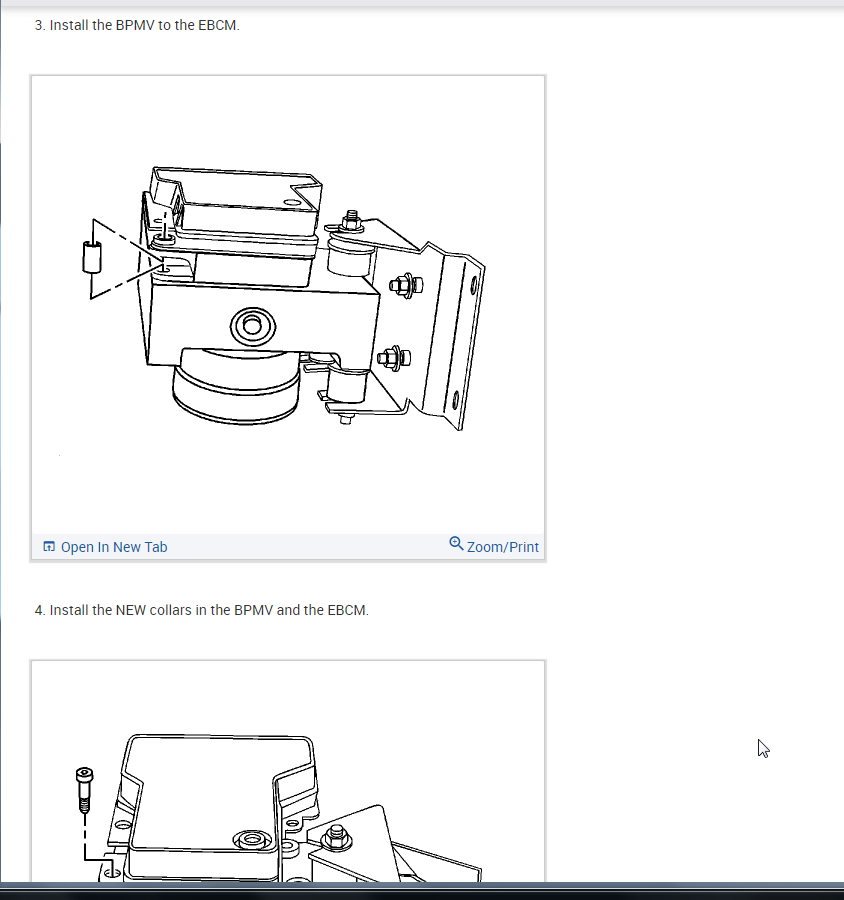

My ABS goes activates on dry roads, then the ABS fault light comes on. speed wheel sensor was replaced. how do i fix?
Feb 20, 2010 at 8:28 PM
Most likely you have a wheel speed sensor that is not reading correctly. However, if you replaced that speed sensor and it is still not reading correctly then you may need to replace the ABS control module.
Here are some guides that will get us started:
https://www.2carpros.com/articles/abs-wheel-speed-sensor-test
https://www.2carpros.com/articles/how-to-replace-an-abs-wheel-speed-sensor

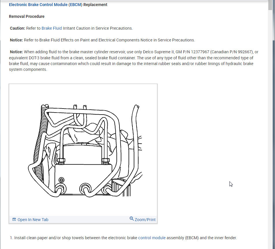

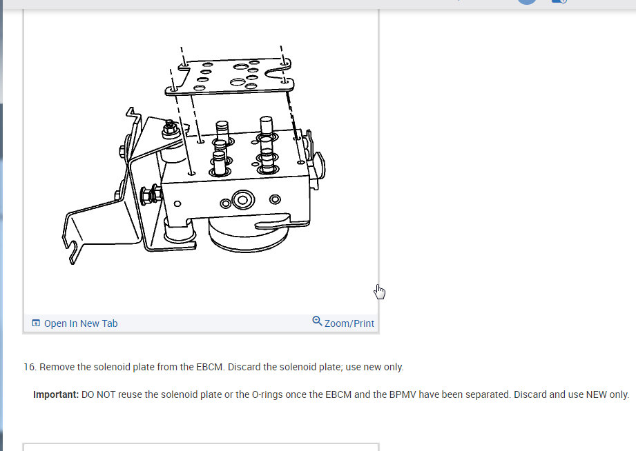

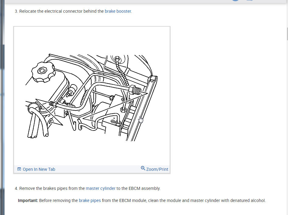

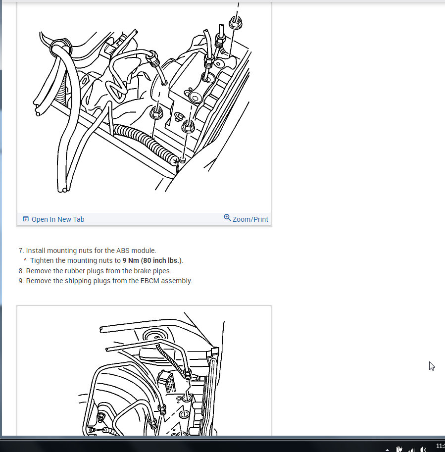

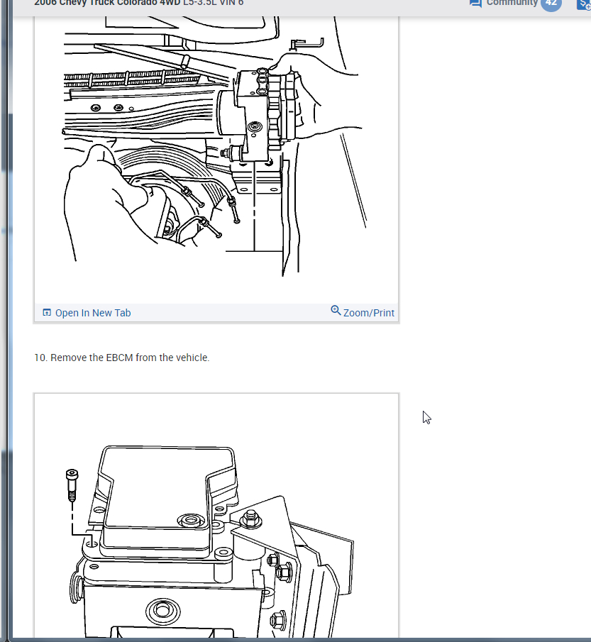

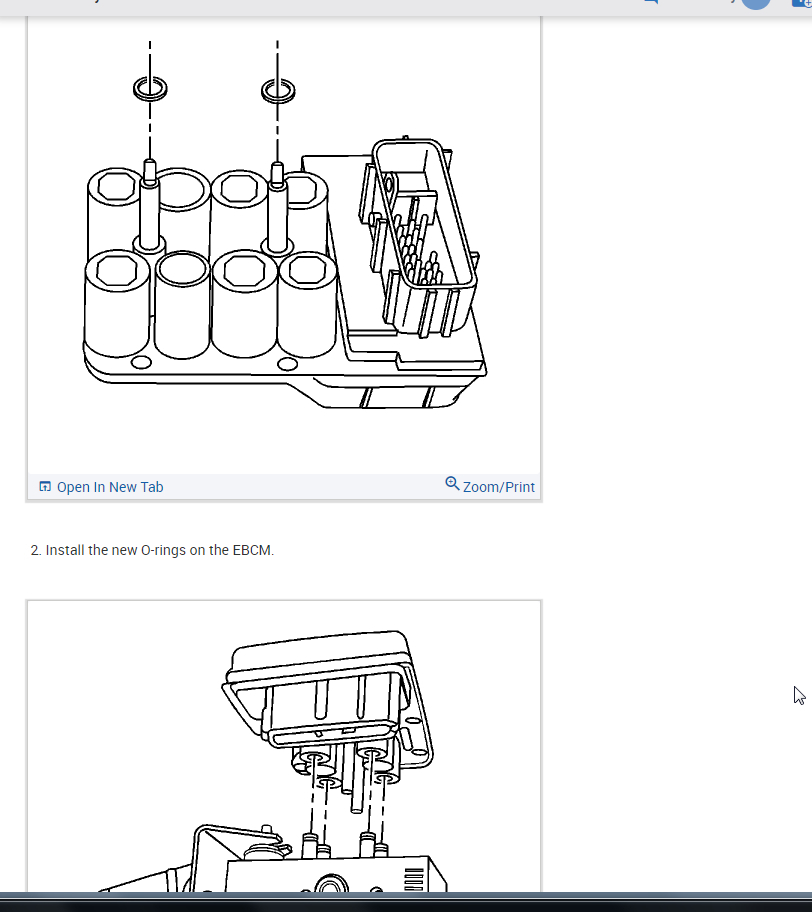

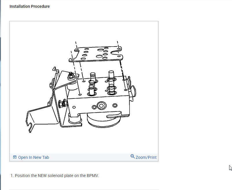

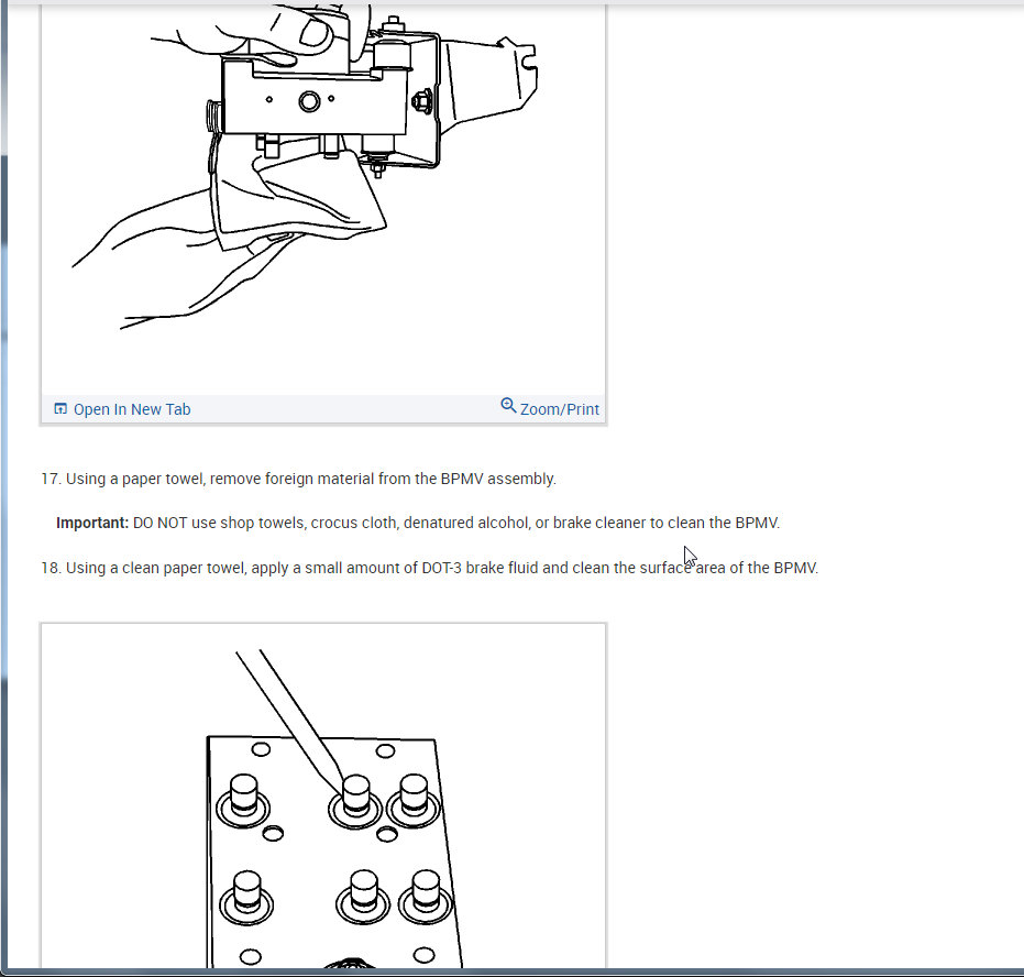

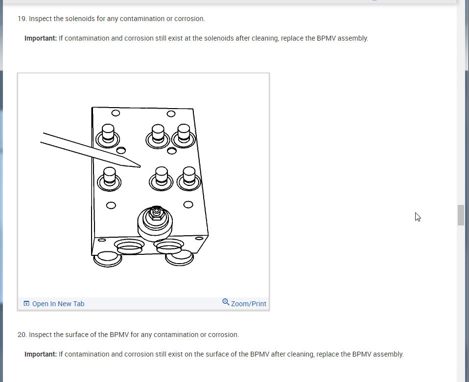

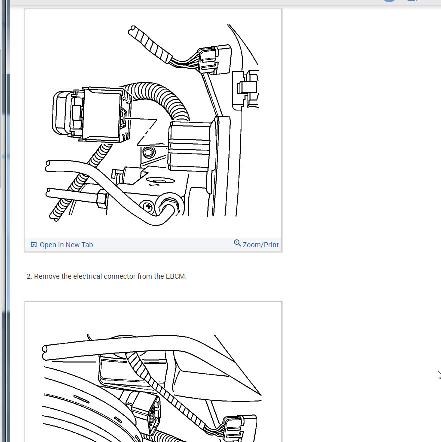

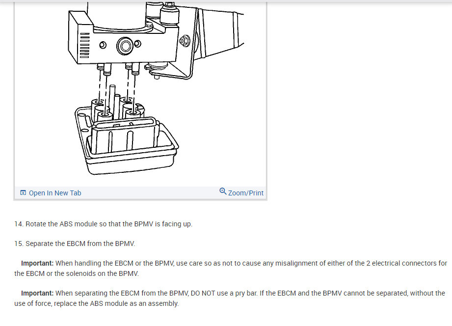

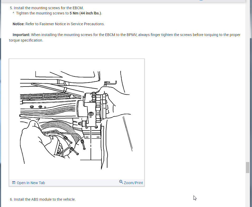

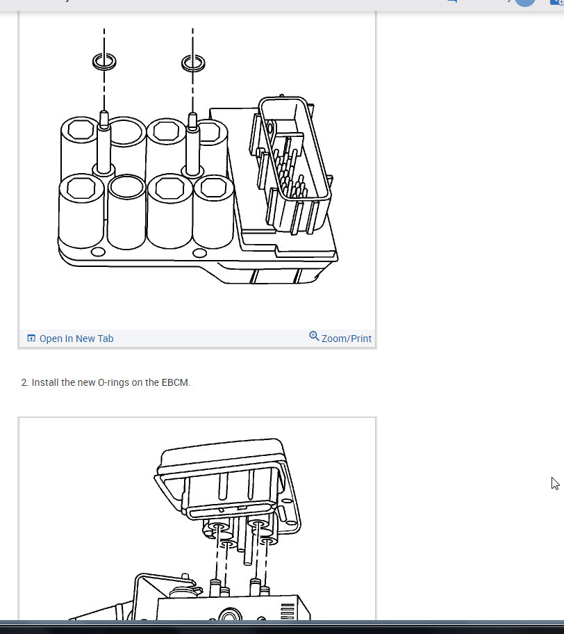

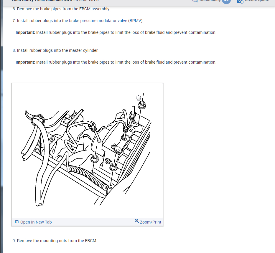

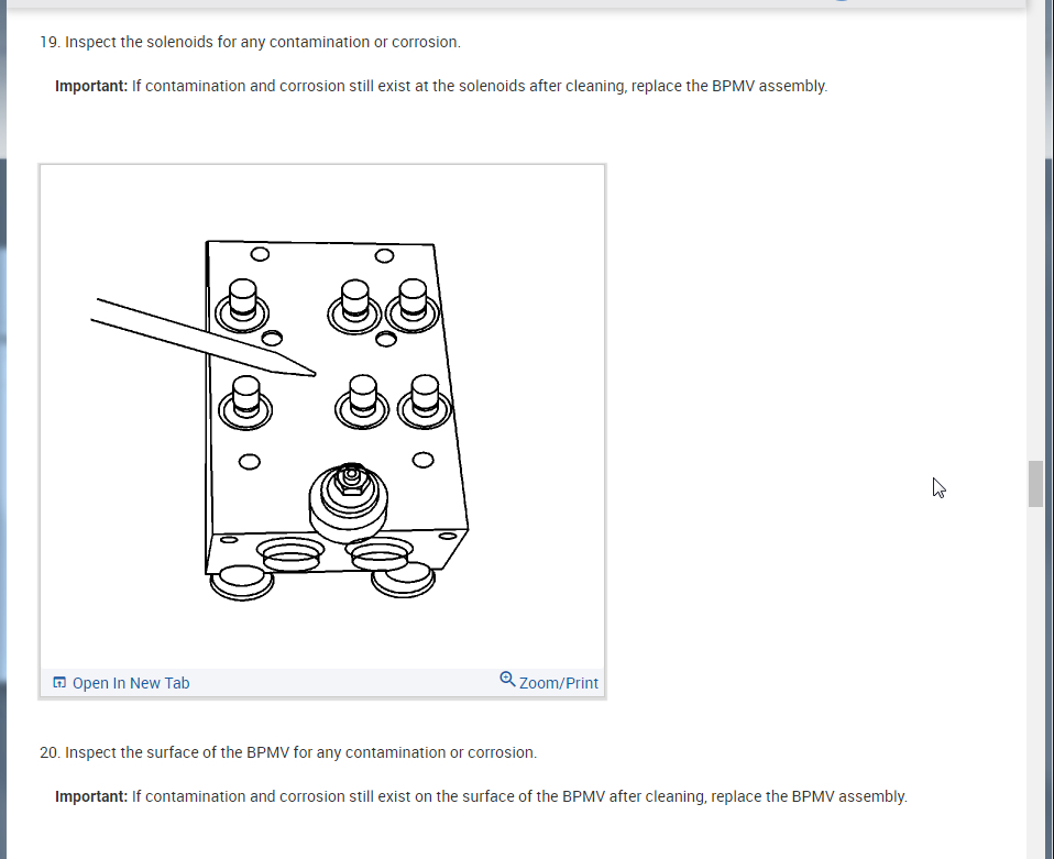

Lastly here is a guide on how to replace the ABS module. Plus attached below is the process from the manual on how to replace it.
https://www.2carpros.com/articles/how-to-replace-a-abs-controller
Let us know if you have questions. Thanks
