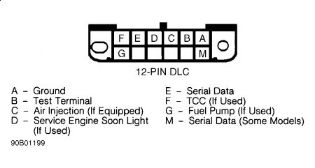

Hi Try reading codes , see diagram, Jumper terminal A & B paper clip works. turn key on no start MIL will flash.Like Flash Flash pause Flash is 21. Post will advise Thanks for donate
https://images.2carpros.com/forum/automotive_pictures/198357_Graphic_48.jpg
