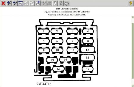

1986 Chevy Celebrity 6 cyl Front Wheel Drive Automatic
I drove my car which started fine to a friends to do some work for her and when I got done, got back to the car I tried to start it and all it would do is turn over. Pushed it home. Checked all the fuses, 1 was bad replaced it checked to see if it was getting spark. It was. Still just turning over any idea on what I can check out next. And where and how would I go about checking - is their a seperate fuel pump fuse thats different than the fuse box under the dash? Any fusable links?

Check fuse no.2 and also check the fuel pressure and injector/s pulses
https://www.2carpros.com/forum/automotive_pictures/12900_fuel_pump_fuse_1.jpg

Thanks rasmataz for your anwser.I will recheck the #2 fuse. Do you know how I would go about checking the fuel pressure and the injector pulses. Is this something I need special tools for.

You need a fuel pressure gauge designed for your fuel system and also a noid lite to check for injection pulses-
