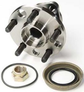

Sounds like the the bearing to me by your description. A couple ways to nail it down. First have the codes pulled from the computer, good chance it will point to the problem child or children if both are a problem. Second, it too raise the front end so the wheels are off the ground, run the motor until the speedometer hit 30 mph and hold it. You may be able to hear which wheel is the noisy one. May need a stethoscope and may need to prevent one wheel at a time from spinning while checking this. My preference is a Timken brand wheel bearing/hub assembly.
https://images.2carpros.com/forum/automotive_pictures/30961_wb_1.jpg
Here is a video for the style of repair https://youtu.be/ZgiPRG6jffc

Suggested Repair
Confirm the noisy driver's-side front hub bearing by scanning ABS codes, raising the front wheels, and checking which wheel makes noise or sends vibration through the strut spring. If confirmed, replace the bolt-in hub/bearing assembly, preferably with a Timken unit.
