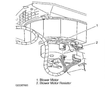

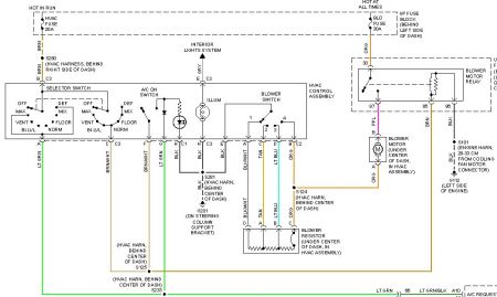

Chevrolet Cavalier, 2001, 120,000 miles. I've had this problem for quite some time and don't know how to fix it. There are 4 fan settings for my car and the first 2 do not work. Any ideas on how to fix it?
Sunday, January 28th, 2007 AT 11:18 PM
SERVICE WRITER
  • 9,123 POSTS
Need to follow the power trail and where it stops. Typically these have a blower resistor that goes.
https://www.2carpros.com/forum/automotive_pictures/30961_cavblo_1.jpg
https://www.2carpros.com/forum/automotive_pictures/30961_cavblodia_1.jpg
