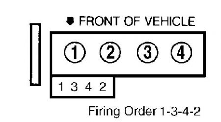

I need to know the orientation of the ignition module so I can put the spark plug wires in the correct position. It is installed on the back of the engine so it's difficult to see it.
I know 2,3,1,4 is the order, but is this from left to right facing the unit, top to bottom, or what. I can't tell if the cylinder #'s are printed on the module.

Don't blast me if I am mistaken but I believe the coils are side by side like this:
https://images.2carpros.com/forum/automotive_pictures/30961_coil_1.jpg
And the drawing of the order is like this:
https://images.2carpros.com/forum/automotive_pictures/30961_order_1.jpg
My drawing is not matching your description in relations to the coil location. With out seeing it I don't know if I'm helping. The coils are usually marked if original, a small mirror will help to check.

Thanks Paul. The mirror is a good idea.
I assume if I had the wires in the wrong order the car would run rough. It's running well right now.
Ralph.

I would say that's accurate. I looked at my wife's car last night to see if it was similiar, but there must have been a design change. The only thing I noticed was the numbers on the plug. You can use a digital camera as well to "look".

Paul (or whomever), I verified the wires are connected properly. Turns out the ignition module is mounted vertically in my car.
