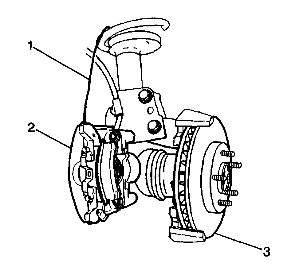

Removal Procedure

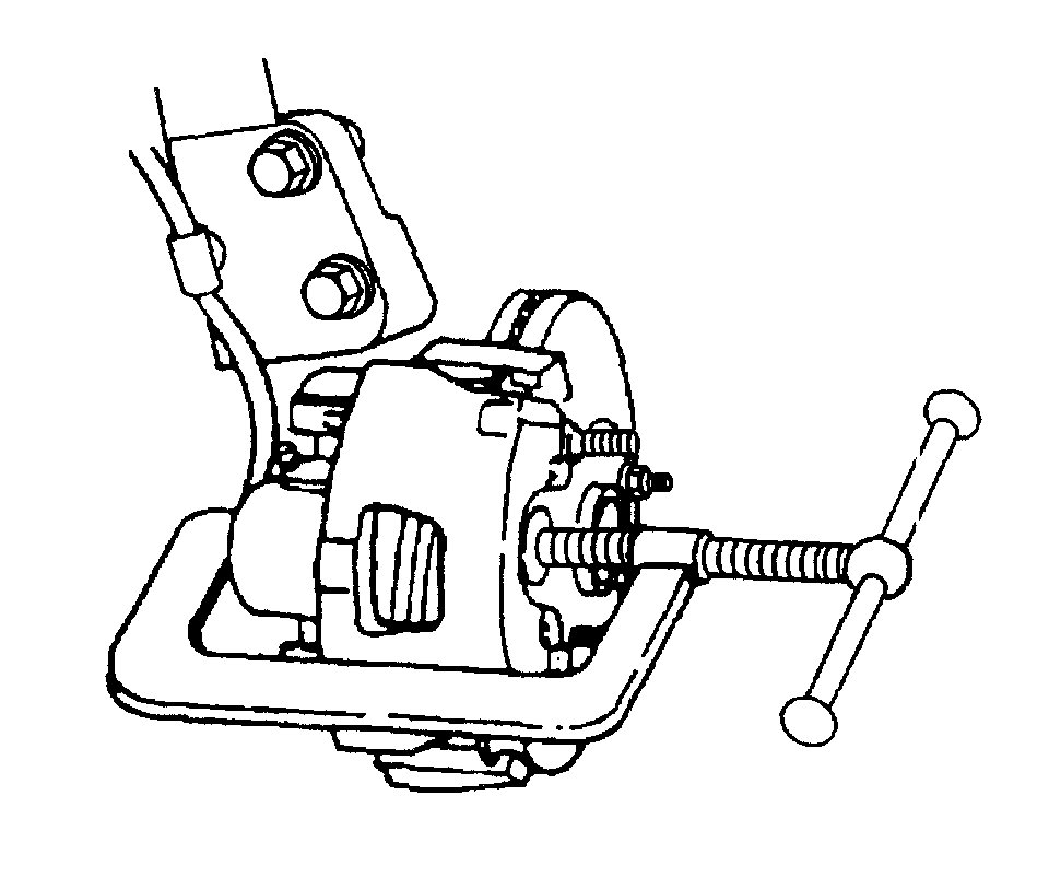

pic 1
1. Inspect the fluid level in the brake master cylinder reservoir.
2. If the brake fluid level is midway between the maximum-full point and the minimum allowable level, no brake fluid needs to be removed from the reservoir before proceeding.
3. If the brake fluid level is higher than midway between the maximum-full point and the minimum allowable level, remove brake fluid to the midway point before proceeding.
4. Raise and support the vehicle. Refer to Vehicle Lifting.
5. Remove the tire and wheel assembly.
6. Install and firmly hand tighten 2 wheel nuts to opposite wheel studs in order to retain the rotor to the hub.
7. Install a large C-clamp over the body of the brake caliper with the C-clamp ends against the rear of the caliper body and against the outboard brake pad.
8. Tighten the C-clamp evenly until the caliper piston is compressed into the caliper bore enough to allow the caliper to slide past the brake rotor.
9. Remove the C-clamp from the caliper.

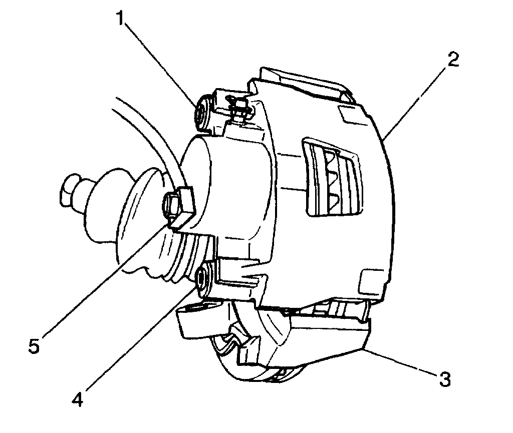

pic 2

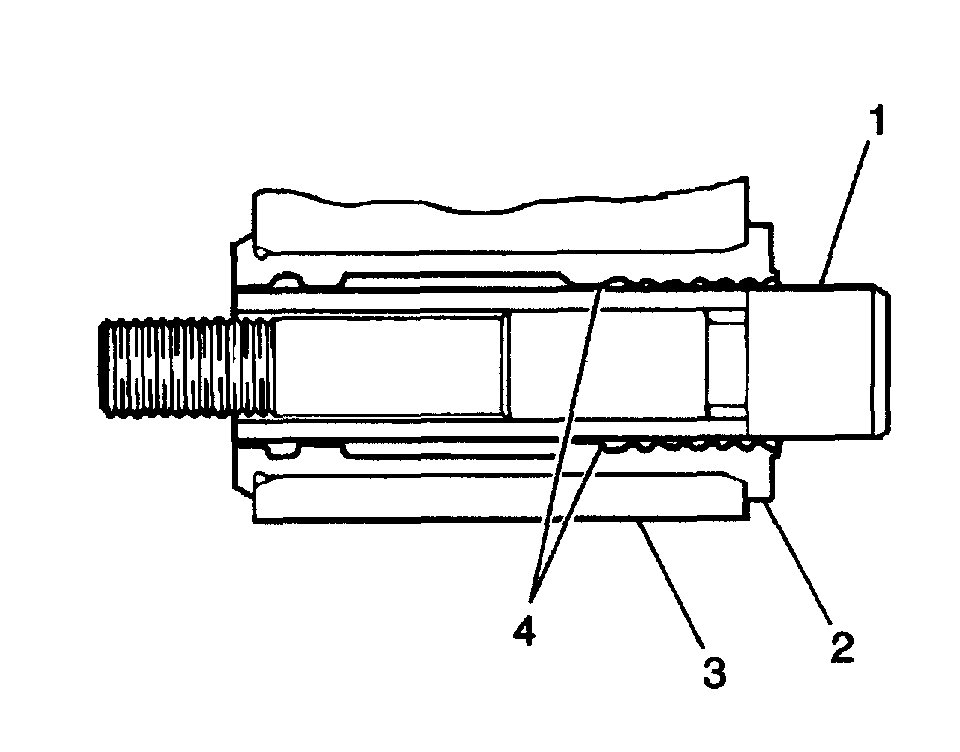

10. Fully loosen the caliper bolts (1, 4) from the steering knuckle (3).

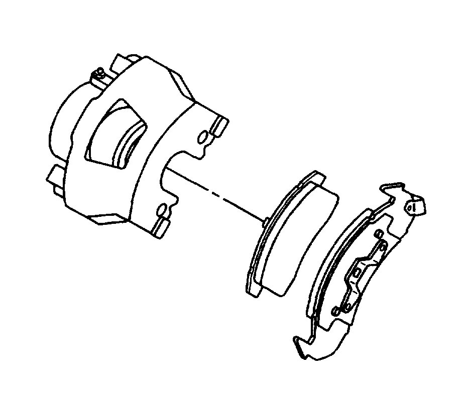

pic 3

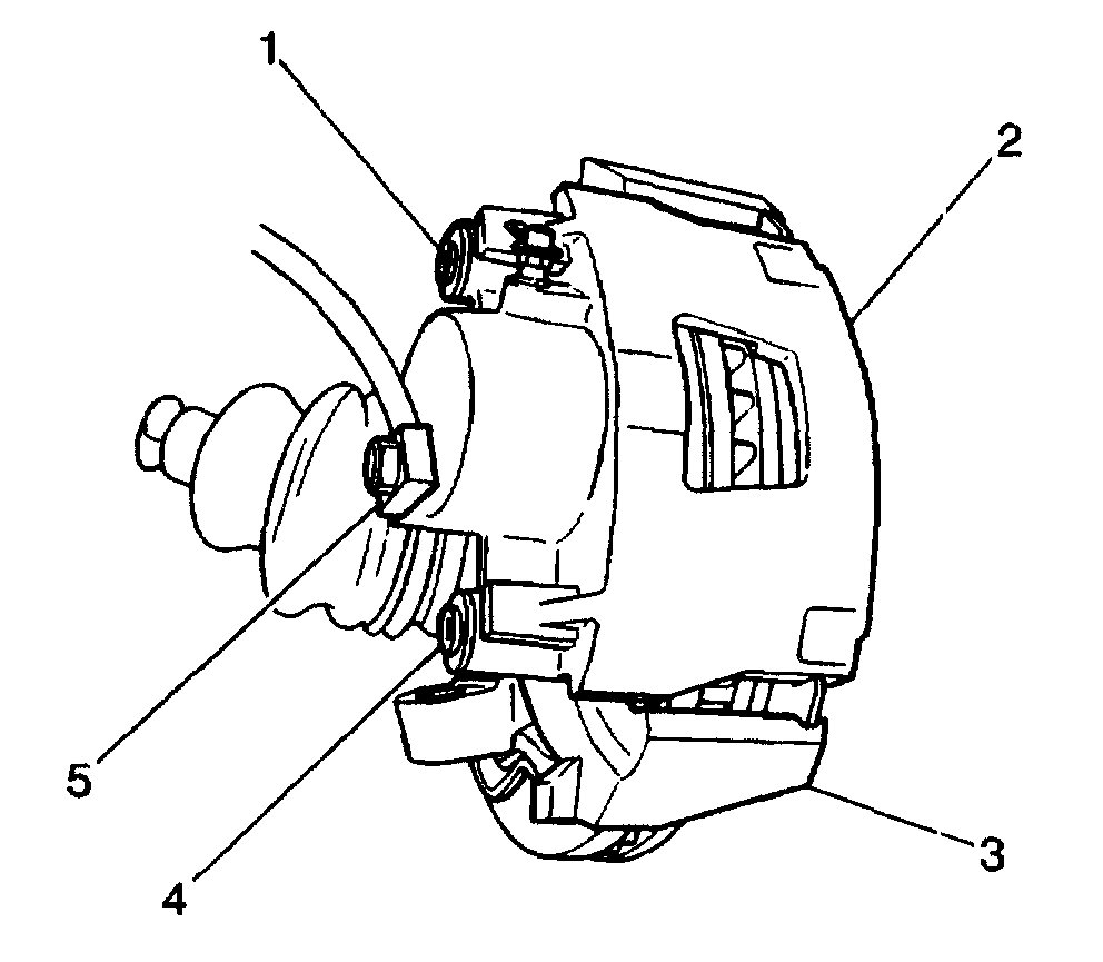

Notice: Support the brake caliper with heavy mechanic's wire, or equivalent, whenever it is separated from it's mount and the hydraulic flexible brake hose is still connected. Failure to support the caliper in this manner will cause the flexible brake hose to bear the weight of the caliper, which may cause damage to the brake hose and in turn may cause a brake fluid leak.
11. Without disconnecting the hydraulic brake flexible hose, remove the caliper assembly (2) from the steering knuckle. Support the caliper with heavy mechanic's wire (1), or equivalent.
pic 4

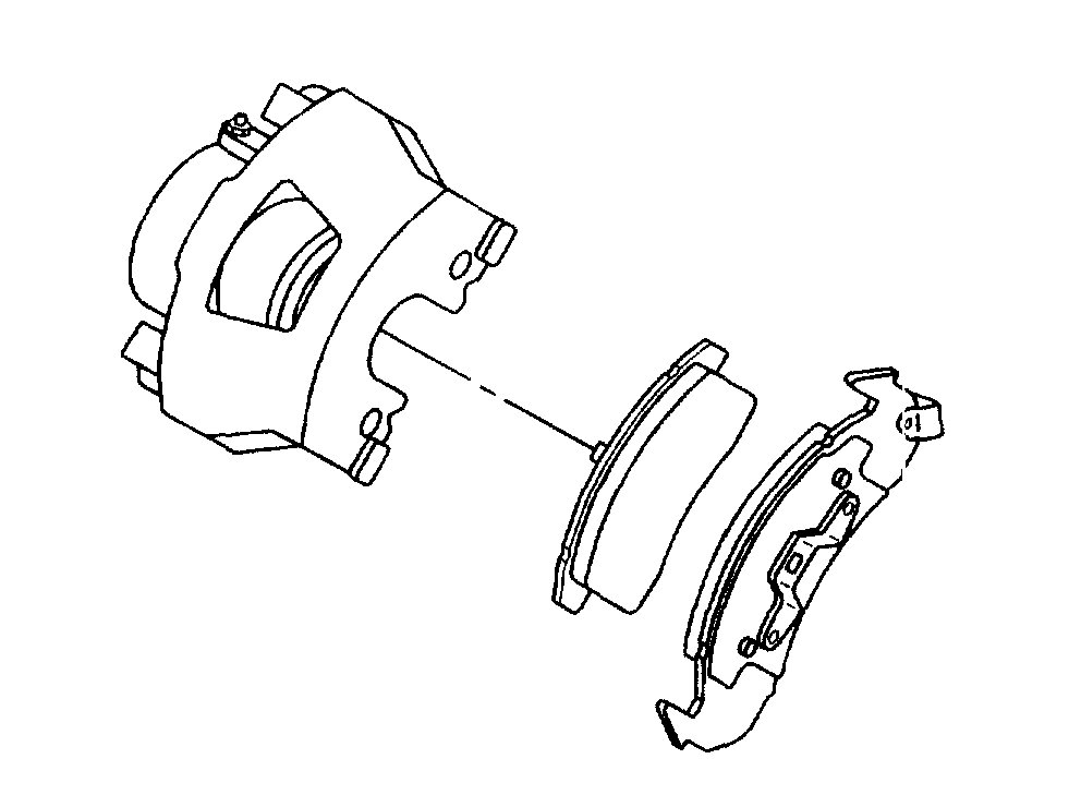

12. Remove the brake pads from the caliper.

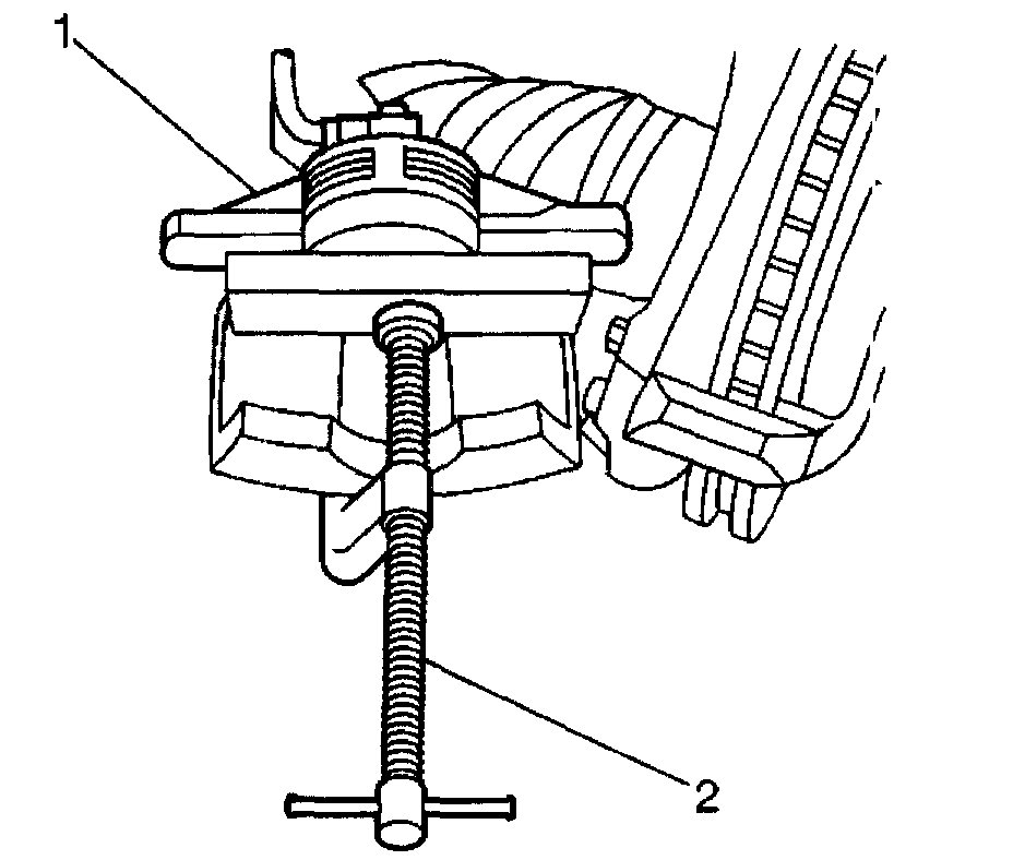

13. Remove the disc brake caliper bolts (1) from the caliper assembly (3).
14. Inspect the caliper bolts (1) for rust, corrosion and/or damage.
15. If the bolts are rusty, corroded, and/or damaged, replace the bolts (1) and replace the bushings (2).

pic 6

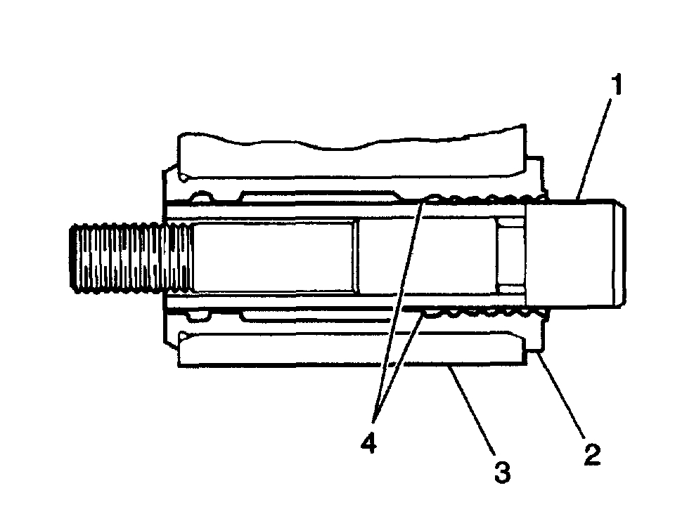

1. Install a large C-clamp (2) over the body of the brake caliper (1), with the C-clamp ends against the rear of the caliper body and against an old inboard brake pad or a wood block installed against the caliper piston.
2. Tighten the C-clamp (2) evenly until the caliper piston is compressed completely into the caliper bore.
3. Remove the C-clamp and the old brake pad or wood block from the caliper.
