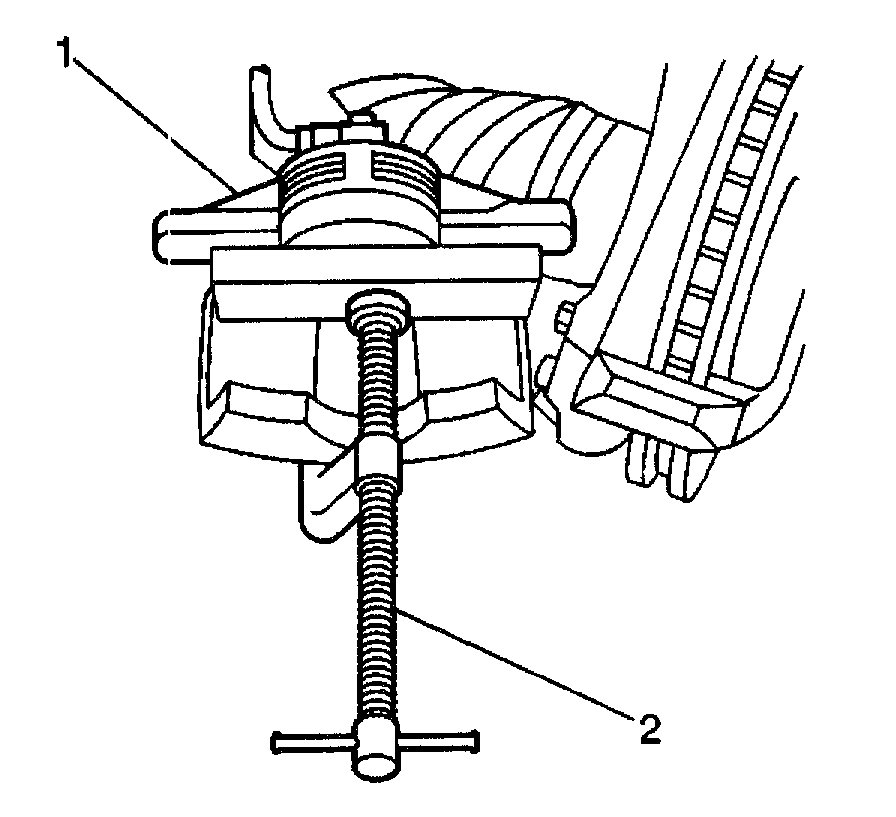

I am changing the front rotors, and pads on my car listed above. I have never done this before. Do I need to reset the caliber on this model, and does the brake line(s) need to be bleed?
If so, can you please tell me how to do this.

No need to bleed system just push calipers back remove caliper bolts and remove calipers and pads replace pads. if you are replacing the rotors remove and replace install all pump brake paddle 5 or so times until up.

pic 1
1. Inspect the fluid level in the brake master cylinder reservoir.
2. If the brake fluid level is midway between the maximum-full point and the minimum allowable level, then no brake fluid needs to be removed from the reservoir before proceeding. If the brake fluid level is higher than midway between the maximum-full point and the minimum allowable level, then remove brake fluid to the midway point before proceeding.
3. Raise and support the vehicle. Refer to Vehicle Lifting.
4. Remove the tire and wheel assembly.
5. Hand tighten 2 wheel lug nuts in order to retain the rotor to the hub assembly.
6. Push the piston into the caliper bore to provide clearance between the pads and the rotor for caliper removal.
6.1.Install a large C-clamp over the top of the caliper housing and against the back of the outboard pad.
6.2.Slowly tighten the C-clamp until the piston pushes into the caliper bore enough to slide the caliper off the rotor.
6.3.Remove the C-clamp from the caliper.

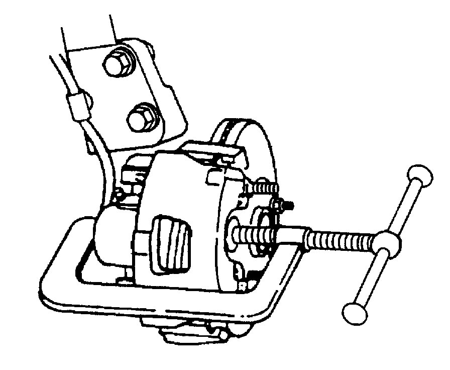

7. Remove the caliper bolts (1, 4).
Notice: Support the brake caliper with heavy mechanic's wire, or equivalent, whenever it is separated from it's mount and the hydraulic flexible brake hose is still connected. Failure to support the caliper in this manner will cause the flexible brake hose to bear the weight of the caliper, which may cause damage to the brake hose and in turn may cause a brake fluid leak.
pic 2
8. Remove the caliper (2) from the knuckle. Suitably support the caliper.
9. Remove the pads from the caliper (2).
10. Inspect the caliper bolts for corrosion or damage.
Use new parts, including bushings, when installing the caliper if any corrosion is found. Do not attempt to polish away corrosion.

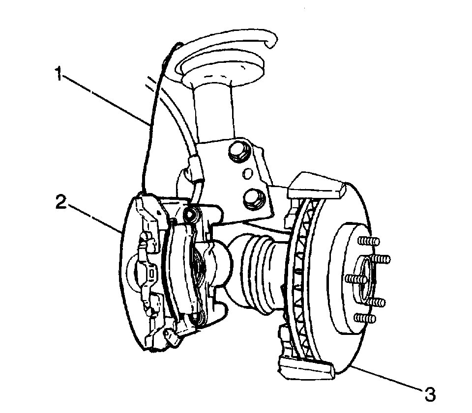

pic 3
1. Bottom the piston into the caliper bore. Use an old brake pad or a wooden block across the face of the piston. Do not damage the piston or the caliper boot.

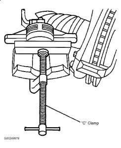

pic 4
2. Install the pads to the caliper (2).
3. Install the caliper (2) to the knuckle.
Notice: Refer to Fastener Notice in Service Precautions.
4. Install the caliper bolts (1, 4).
Tighten
Tighten the caliper bolts to 51 Nm (38 ft. lbs.).
