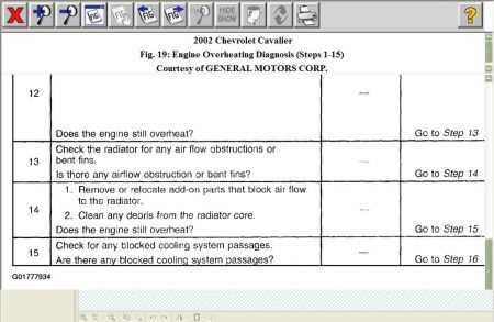

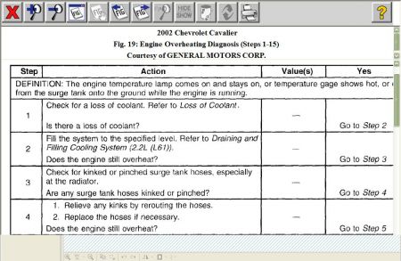

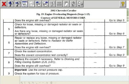

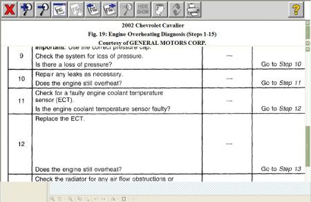

Could be the water pump
One way to test for a bad water pump is to squeeze the upper radiator hose when the engine is hot and idling. Careful, because the hose will be HOT! If you do not feel much coolant circulating through the hose when you rev the engine, the pump may be bad. The other cause might be a clogged radiator.
Try bleeding it-don't work get it block and pressure tested
Jun 25, 2008 at 4:16 PM
JUDYCORLEY
Replaced the water pump about 2 months ago? Could the type of antifreeze cause the problem?
Jun 25, 2008 at 4:40 PM
  • 75,992 POSTS
Its suppose to use DEXCOOL type antifreeze not the green stuff
