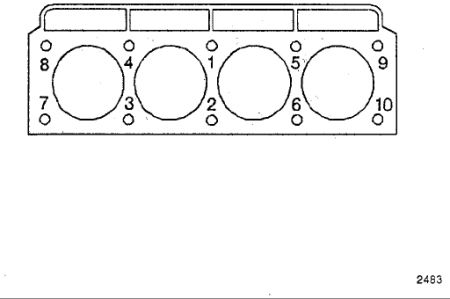

AEF43
I recently asked for the torque ratio and sequence for the cylinder head bolts on a 1997 chevrolet cavalier 4 cylinder 2.2 liter engine. I did recieve the info but is that the sequence if i am standing right in front of the car looking at the head. I don't want to do it upside down if you know what i mean. Thank You!
Mar 27, 2020 at 5:40 AM (Merged)
BMRFIXIT
  • 19,053 POSTS
hit replay to question so you keep all in one place
https://images.2carpros.com/forum/automotive_pictures/99387_Graphic1_699.jpg

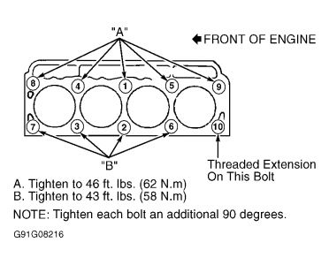

AEF43
I need the torque ration on the 10 cylinder head bolts on the vehicle specified above will you please help. Thank You!
Mar 27, 2020 at 5:41 AM (Merged)
TOOOMANYTOYS
  • 513 POSTS
Tighten bolt 1 to 63 Nm (46 ft. lbs.) . Tighten bolt 2 to58 Nm (43 ft. lbs.) . Tighten bolt 3 to 58 Nm (43 ft. lbs.) . Tighten bolt 4 to 63 Nm (46 ft. lbs.) . Tighten bolt 5 to63 Nm (46 ft. lbs.) . Tighten bolt 6 to58 Nm (43 ft. lbs.) . Tighten bolt 7 to58 Nm (43 ft. lbs.) . Tighten bolt 8 to 63 Nm (46 ft. lbs.) . Tighten bolt 9 to63 Nm (46 ft. lbs.) . Tighten bolt 10 (stud bolt) to 58 Nm (43 ft. lbs.) . Use a torque angle meter and tighten all the cylinder head bolts an additional 90 ° in sequence
https://images.2carpros.com/forum/automotive_pictures/462613_head_1.jpg

MHPAUTOS
  • 31,937 POSTS
Hi there, See pics for torques & sequence. mark (mhpautos)
https://images.2carpros.com/forum/automotive_pictures/61395_Graphic_53.jpg
https://images.2carpros.com/forum/automotive_pictures/61395_torques_1.jpg
