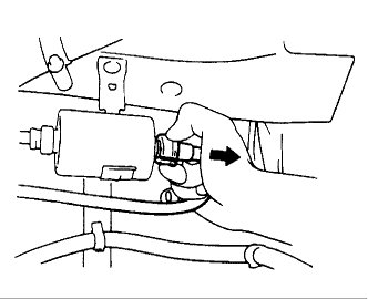

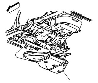

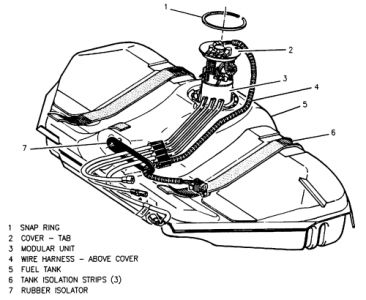

Hi and thanks for using 2CarPros.com. To remove the fuel tank will require more than on size. However, if you are referring to the fuel tank retaining straps, I believe they are 14mm.
Here are specific directions for replacing the tank in your vehicle. I have also attached pictures to help guide you.

Grasp the fuel filter quick-connect fitting. Twist quick-connect fitting 1/4 turn in each direction to loosen any dirt within fitting.
CAUTION: Wear safety glasses when using compressed air in order to prevent eye injury.
Using compressed air, blow out the dirt from the quick-connect fitting at end of fuel filter quick connect.
Remove the quick connect fittings by pulling release tabs back on the fuel line quick connector and pulling apart.

With the aid of an assistant, support the fuel tank and disconnect the two fuel tank retaining straps.
Lower the fuel tank (1).
Remove the fuel tank pressure sensor electrical connector.
Remove the fuel sender electrical connector.
Remove the tank from vehicle.
Remove the fuel sender assembly from the tank.

Install the fuel sender assembly to tank.
With aid of an assistant, raise the fuel tank to the body.
Install the fuel tank pressure sensor electrical connector.
Install the fuel tank sender electrical connector.
Install the fuel tank (1).
Install the fuel tank retaining straps. Tighten the bolts to 35 Nm (26 lb ft) .
