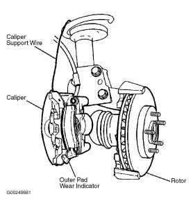

How to get rotors off a 2000 Chevy calviler
Tuesday, September 9th, 2008 AT 3:50 PM
BLACKOP555
  • 10,371 POSTS
Remove wheel after vehicle is jacked up and supported, next step would be to remove the brake caliper and wire it up or hang it on the strut that way you dont stretch out the brake line and damage it.
after that remove the rotor, will pull right off. it may have to be hit on with a hammer on the inside between the lugs to knock the rust loose if it wont come off. make sure the flange behind rotor is clean before reinstallation of the new rotor, if old rotor is being used mark it that way you know how it was when it was on.
see ilustration.
