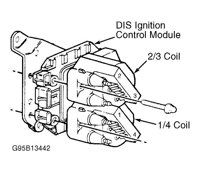

DOCFIXIT
  • 18,828 POSTS
Maybe ignition control module see diagram

DANSMITH
caronly fires on 2 cilinders. alredy changed one coil pack on cilinders that dont fire also replaced pluge wires.
Oct 16, 2020 at 4:24 AM (Merged)
SERVICE WRITER
  • 9,123 POSTS
What cylinders weren't firing before the coil?
What ones are not firing now?
take your time. ;-)
DANSMITH
first and last on block. both wires wernt to same coil.could it be o2 sensor
SERVICE WRITER
  • 9,123 POSTS
Pretty sure the those are on separate coils. 1&4 and 2&3. Swap the coils and see if the misfires move to the other cylinders.
