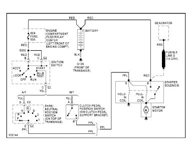

I am trying to reconnect a starter that was removed before I received it. The wires were cut and not labeled. Could you tell me what color wires belong to what part.

What do you have for engine size?

The engine is a 2200

Purple wire goes on the S terminal (small)
Red and gray goes on B terminal (big)
https://www.2carpros.com/forum/automotive_pictures/99387_5239bl_13.jpg
