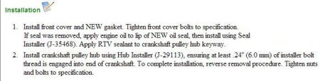

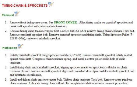

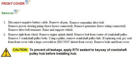

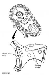

i am a boat mechanic so you can skip the explainations for a five time a year mechanic. Just wanted to get a procedure for replacing a timing chain on this car I got for $100.00 bucks I just replaced the c/v axles, spindles, etc. It looks like taking the right side fender liner out and loosening the top motor mount so the engine can be supported by a jack and let down far enough to get to the h2o pump and harmonic balencer. What other procedures do I need or do you have a schematic that I could look at?

https://www.2carpros.com/forum/automotive_pictures/261618_Noname_1492.jpg
https://www.2carpros.com/forum/automotive_pictures/261618_Noname2_439.jpg
https://www.2carpros.com/forum/automotive_pictures/261618_Noname3_162.jpg
https://www.2carpros.com/forum/automotive_pictures/261618_Graphic_279.jpg
